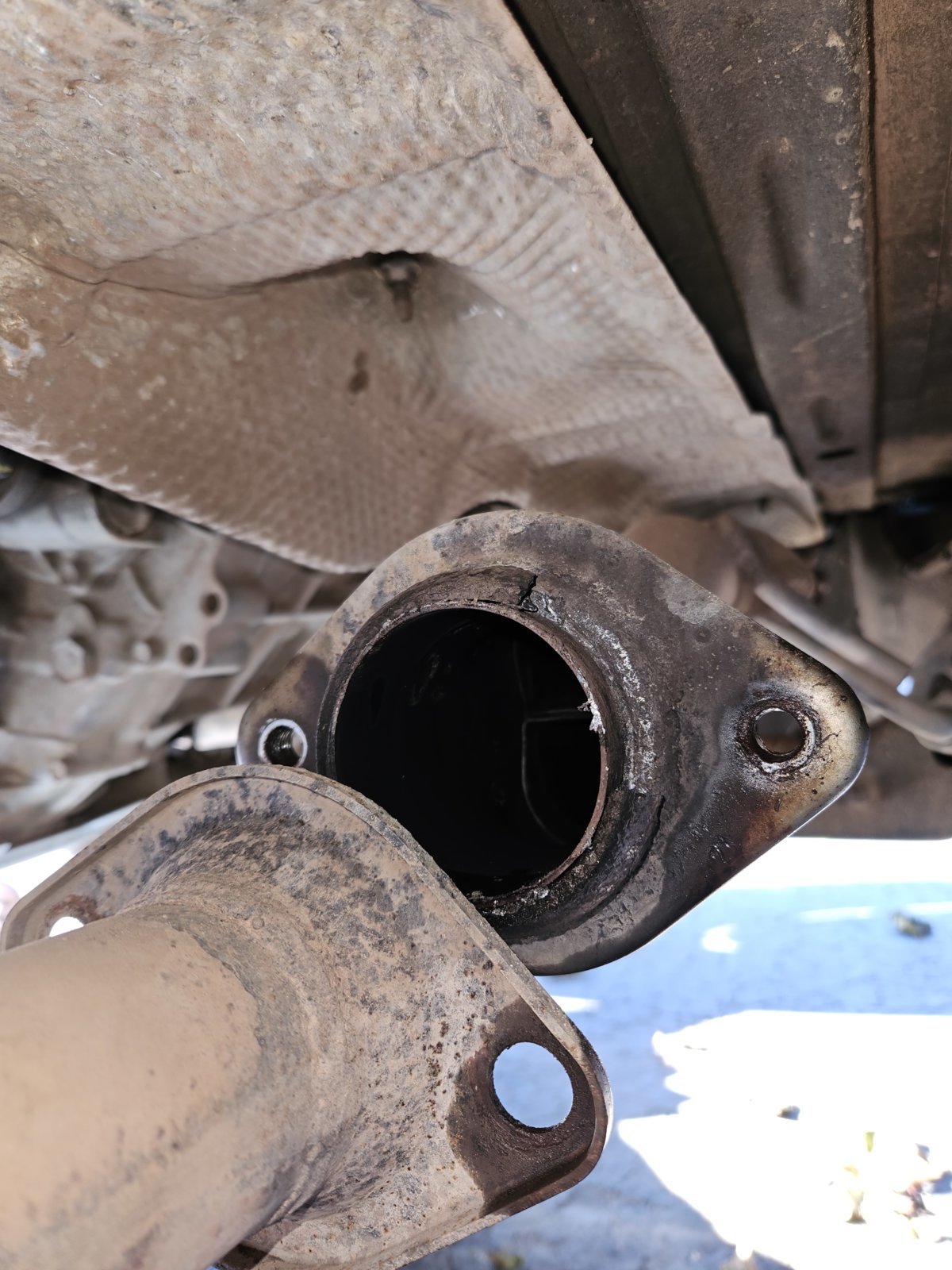

    Where is the noise coming from? I had an exhaust gasket disintegrate on me last year. Only made noise at idle in gear
    Downstream of the cats where it Y's into one pipe

    I had a heat shield clamp from the upper cat shield rusy off and was on the exhaust pipe near the T case and ONLY rattled at idle

    Heat shield for the converter, exact same thing my 2010 did.

    There are vertical supports on the flanges of the cats. These can rust out right along the edge of the flange, leading to hard to find rattling. In my case, it rattles a bit at higher RPM in park and sometimes at idle in drive, as well as clunking slightly sometimes at odd angles/speeds/bumps (which had me chasing suspension clunks for a year).
