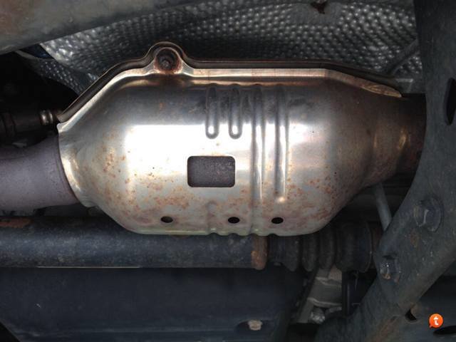

    In my case, it's this heat shield, anyone know if this is the correct part # - 18435-0P020 (upper)
    I may grind the nuts off. I've have been trying liquid wrench, but the nuts will not move.
