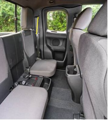

    Mine caused by seat buckle tapping around, take the buckle insert into the slot above and all the noise is stop :) (see yellow line for an idea).
