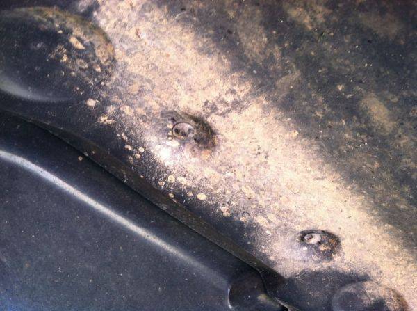

    I think I have finally narrowed down what is rattling over bumps. When I was waxing the truck today I noticed that the wheel well liner doesn't seem securely fastened to the truck bed. It uses some funky plugs with a metal collar so no way to fasten it down tighter. Anyone else have this issue or a fix or should I just deal with it rattling over every little bump? Here is a pic for reference....

    Eh? Nobody else has this issue?

    Can you remove the plastic clips and install nuts and bolts?

    I'm not sure, had to rush to work so I didn't really look at it too much. There is a good 1/4 inch gap between the liner and the bed so it rattles like a SOB.

    Mine has had that for a long time. Rattles when I shut the doors. The nut and bolt idea seems like a good one.

    I never did bolt them. They are just plastic clips holding them in place. Push them in until they click all the way down.

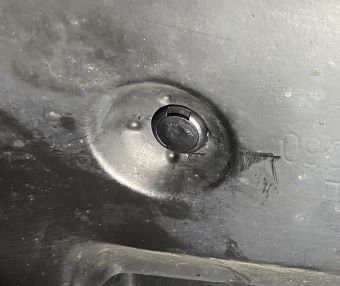

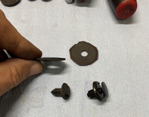

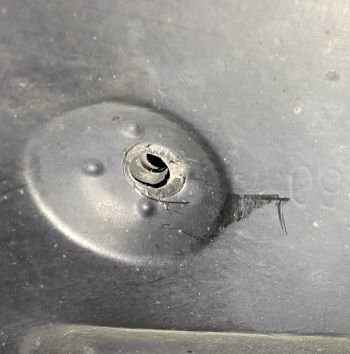

    Know this is an old thread (couldn't find a newer one), but my son's truck had the same rattle from the factory push pins not being tight enough.
    I made some rubber washers to go between the liner and bed. Replaced the OEM push trees (on the left) with push pins.
    Sorry for the small pic, they came from a push pin kit I got off Amazon. Size is 20mm / 11mm / 8mm
    Rubber washer between liner and bed
    I removed the pins from the sockets to make them go in a little easier. They're a snug fit.
    Pins were a firm push to get to get in, but they're solid, and no more rattle / buzz.
