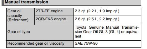

    The manual calls for GL4, GL5 has additives that are no good for synchros.
    I'm going to use a GL4. I just was curious if anyone had used this GL4.
