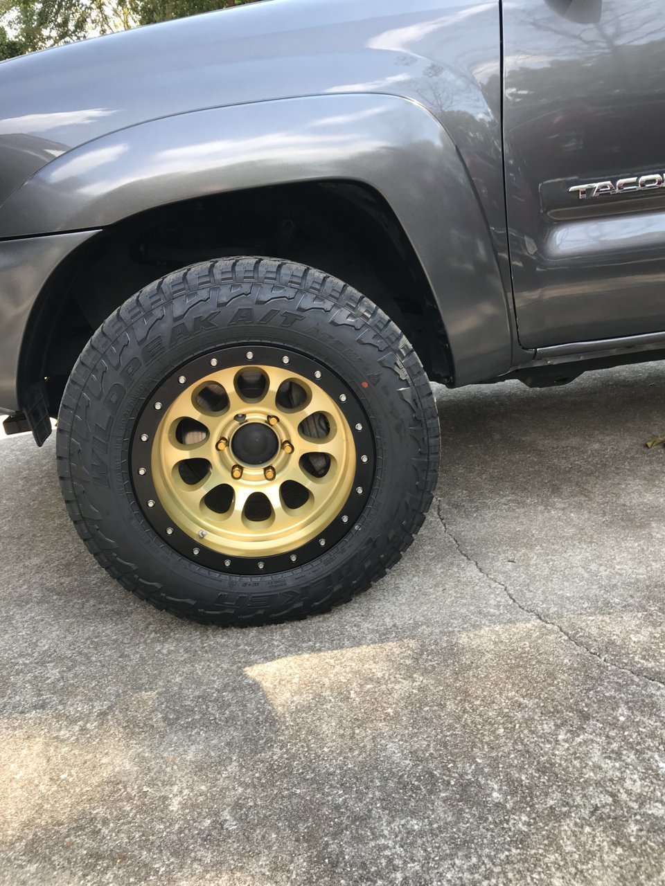

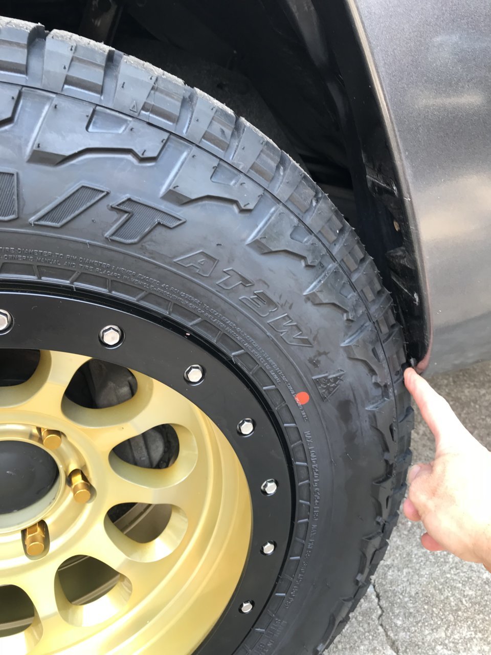

    i just installed my new tires and wheels and can’t drive my truck. I have 17x9 wheels what do I need to do now ?
    I’m not taking off the fender flares.....
    Thanks

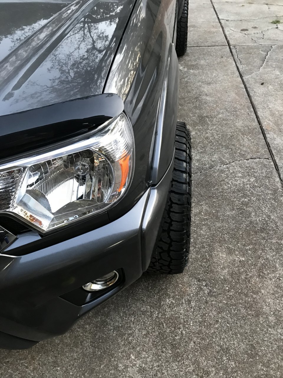

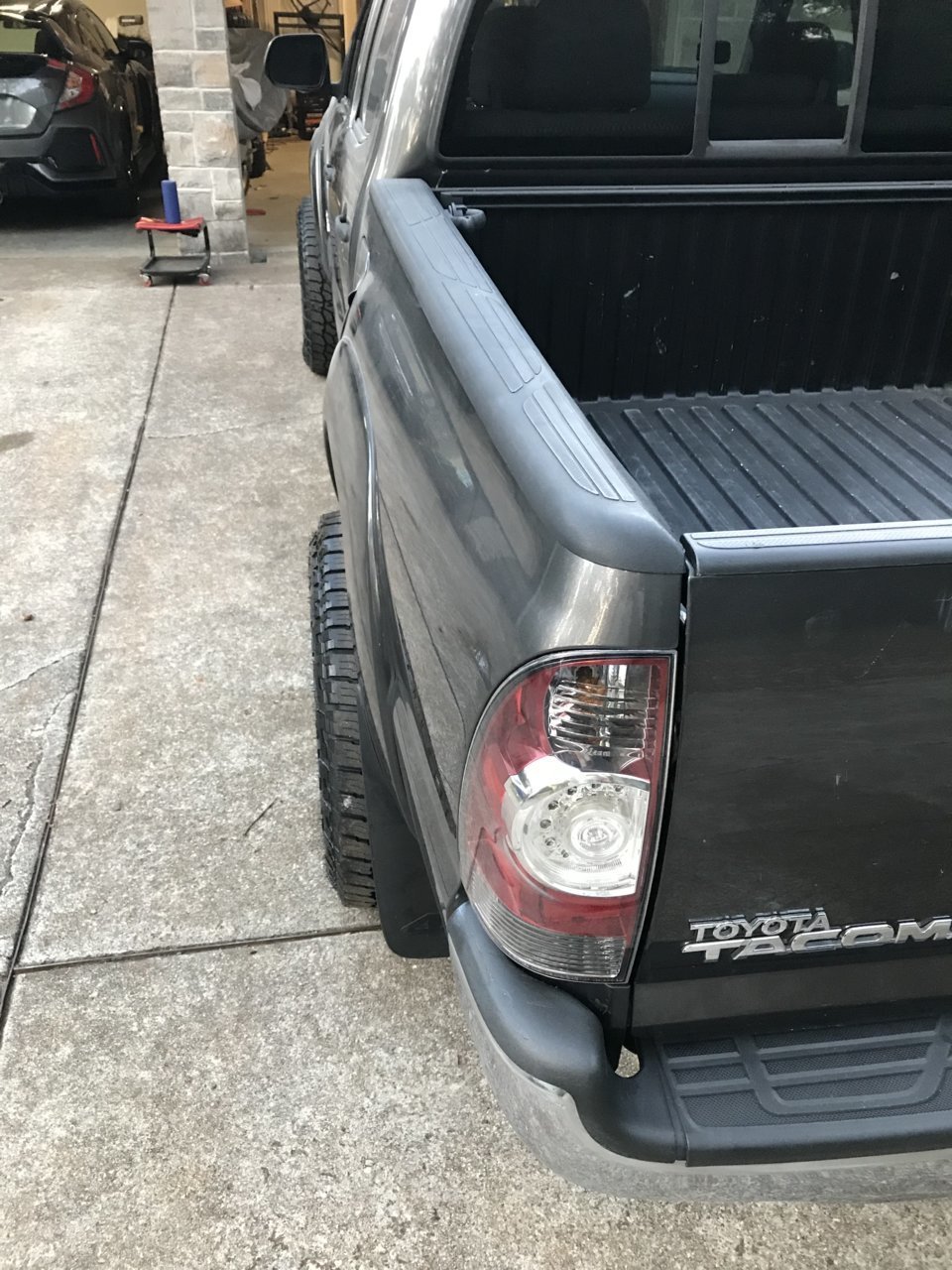

    Here’s the poke

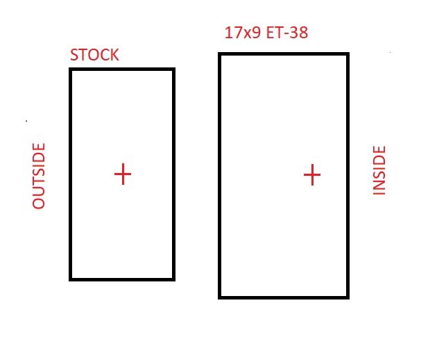

    This is a top view of what is happening with high negative offset wheels.
    The red cross shows where your SAI is. This is the axis on which your tire turns.
    With high negative offset, the outside corner of the tire rotates about a larger radius. Thus, moving forward and aft more when turning.
