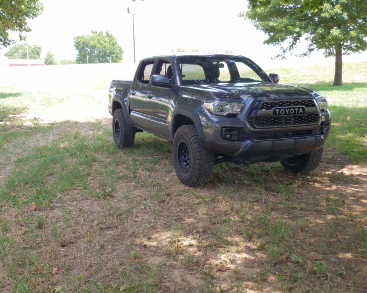

    Current picture

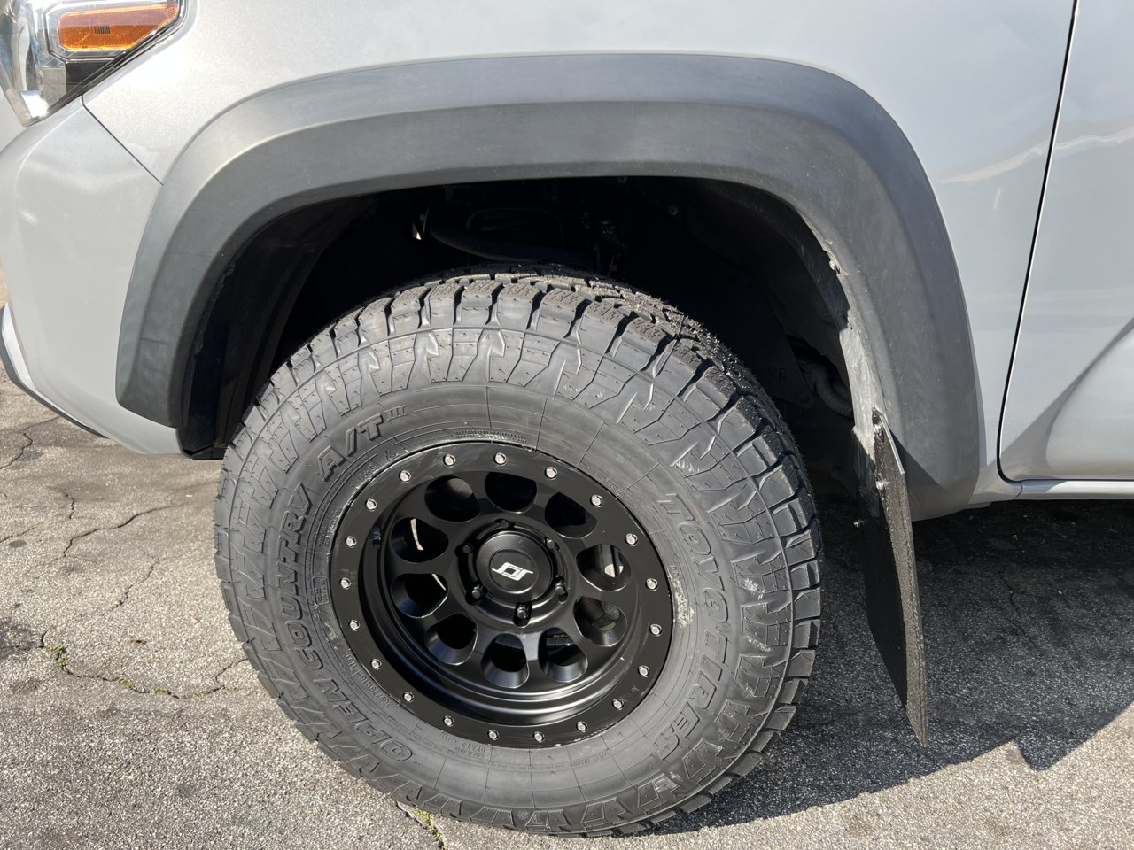

    I just mounted 16x8 Ray10s on 265/75. I went with RokBlokz flaps because I like the look and protection. I had to heat gun the front wheel well liner, rear location. I was contacting when fully locked.
    The contact/rubbing is gone now but I’m going to keep an eye on it to see if certain scenarios produce a rub.
    I really wonder how this is going to do off-road. It has me contemplating a moderate lift, like 5100s/887s and AAL.
    I can post a pic after heat gun if anyone’s interested.

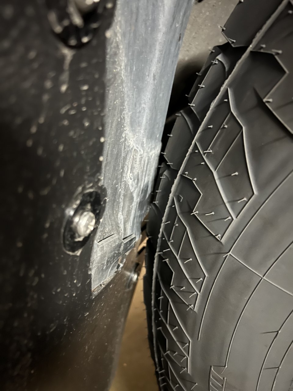

    Yeah I just had a pretty rough rub on the passenger side, turning right into a drive. I gotta figure out what to do.
