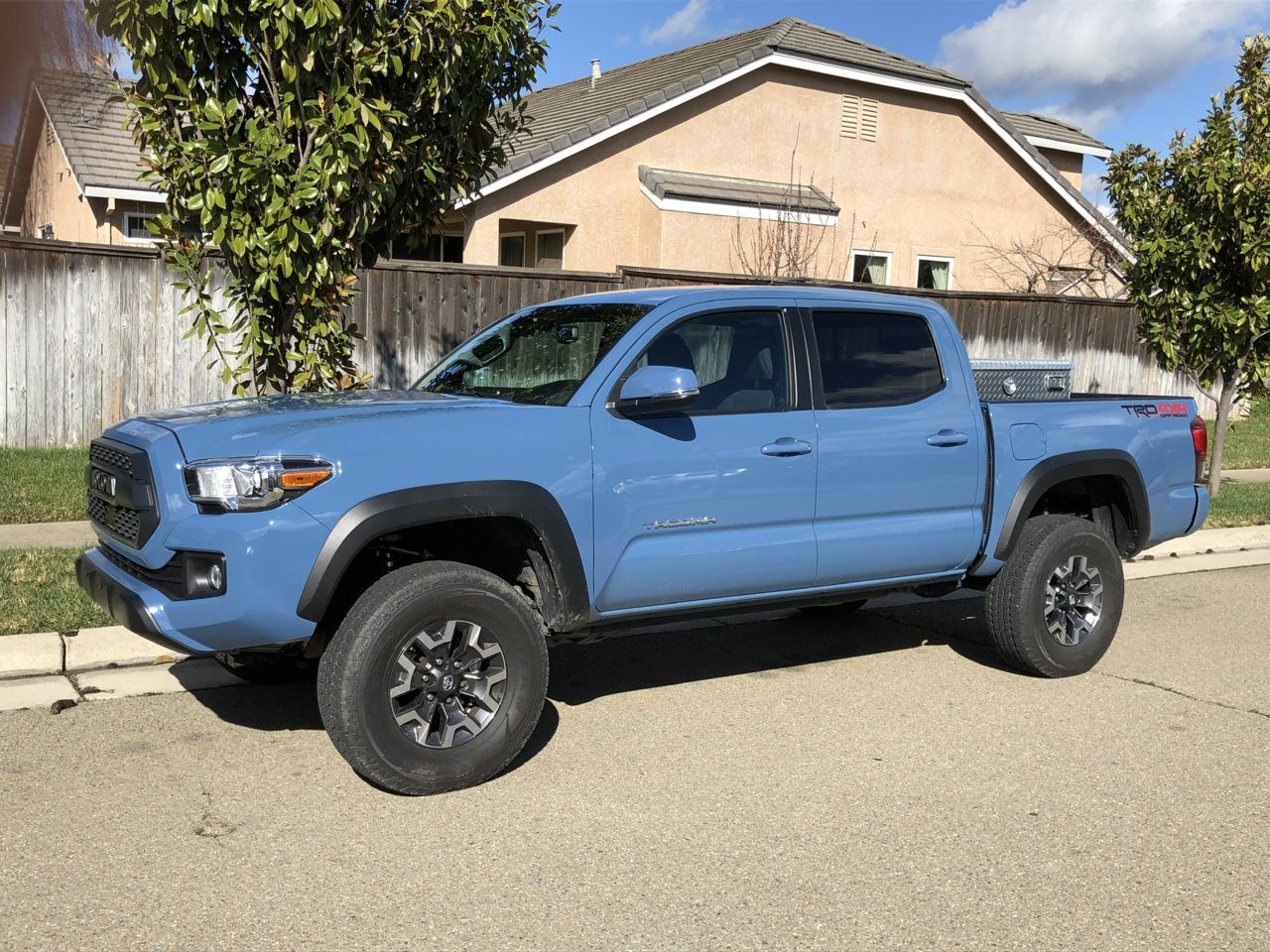

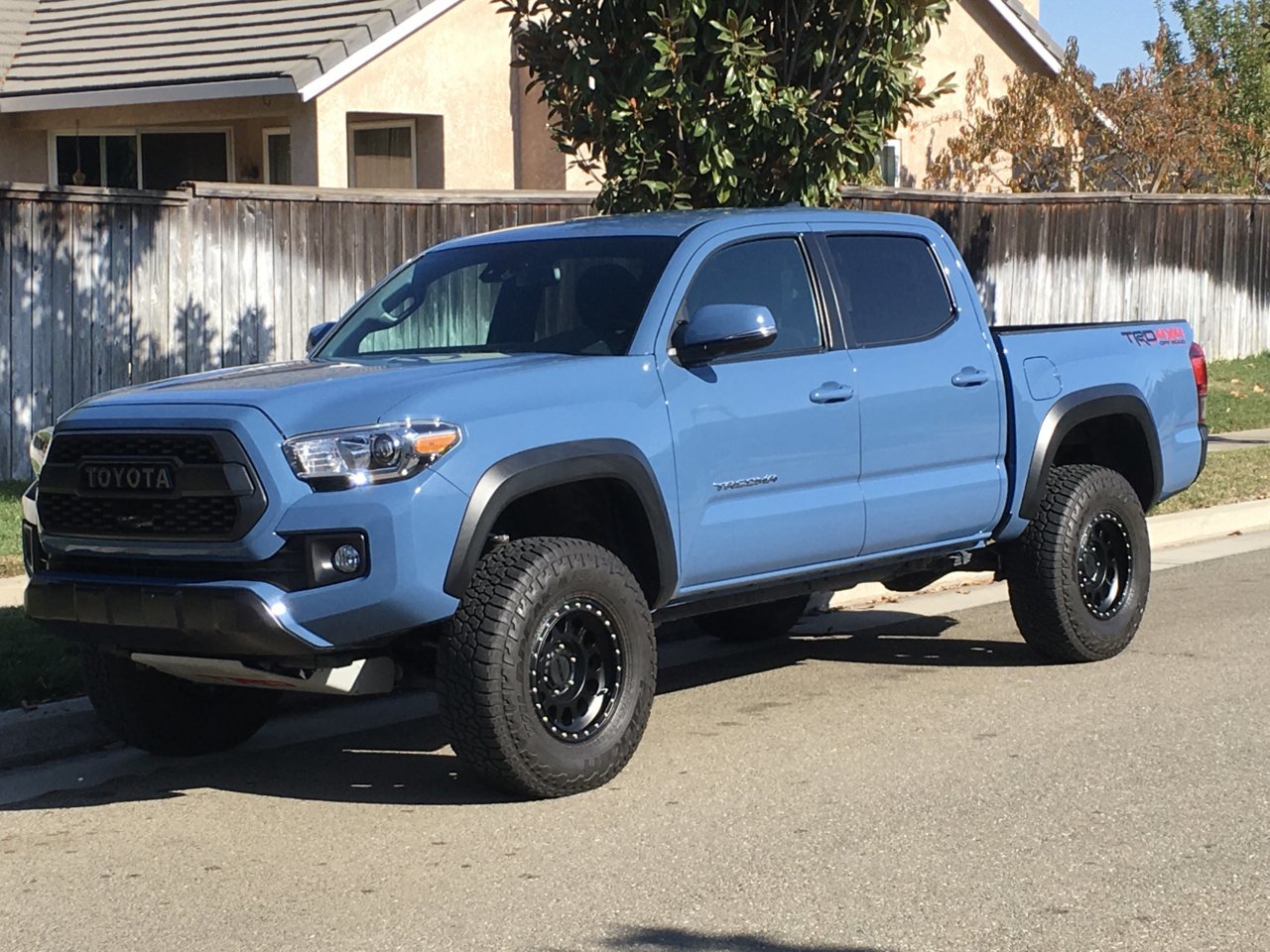

    Might I suggest the new Method MR315s? Very similar to 305s but they are “hub centric.” 305s are lug centric... everything else is very similar if not the same. 16x8 with 0 offset, 4.5 backspace and they come in bronze —plus the center caps are recessed and bolt on.
    Here’s my truck with them and 265/75/R16 Wildpeaks. I ran these tires on my stock off road rims with the same suspension and I swear it feels like I lifted my truck just by changing the wheels...

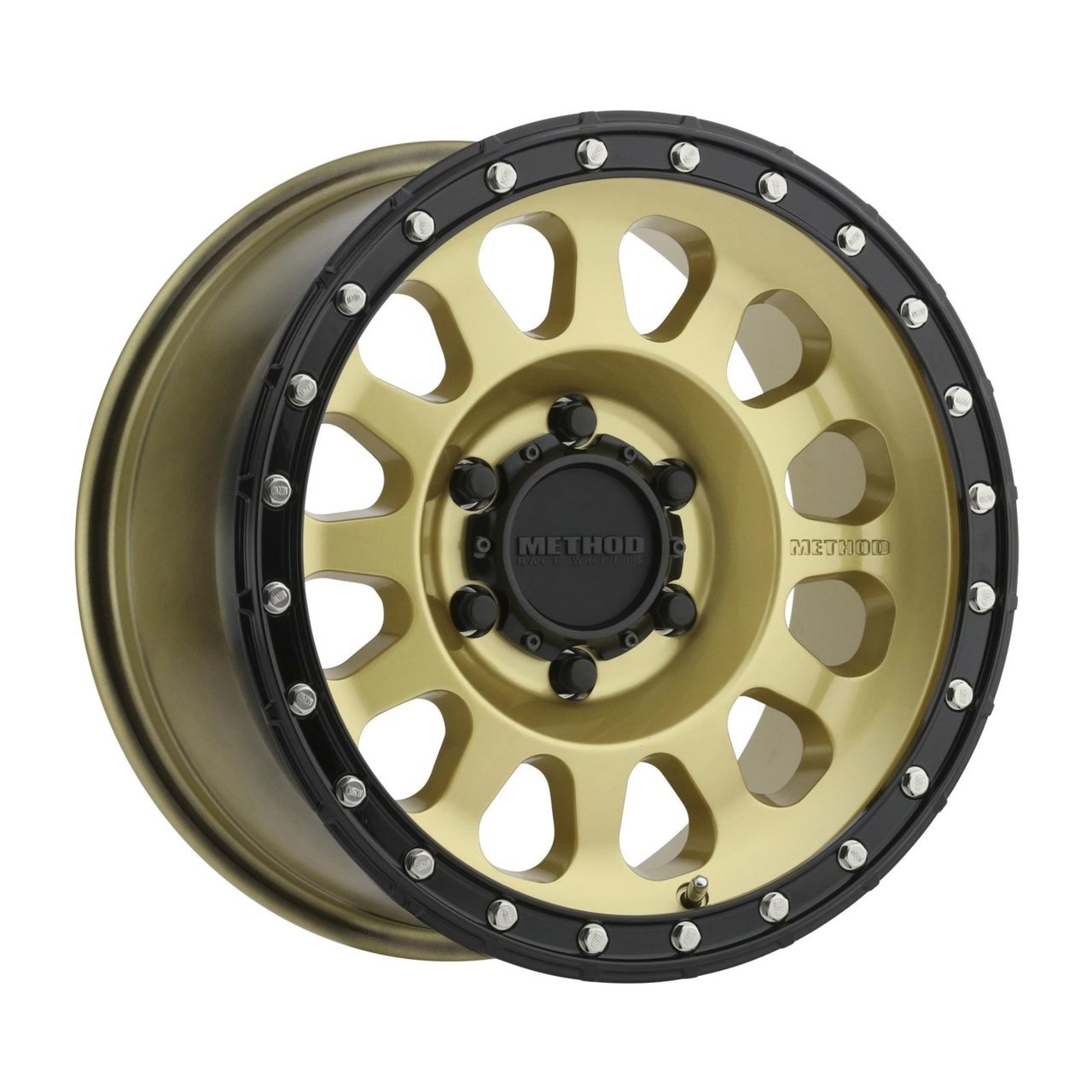

    Thanks everyone! Per Arietta’s advice I went with the Methods MR315’s.
    16x8, Gold/Black Plus Wildpeaks. Install next week....killer deal at America’s Tire.

    Damn those are ugly, but they look good in your truck

    I like those wheels with the tire combo... How much do they stick out? pictures will help too. Thanks, :thumbsup:

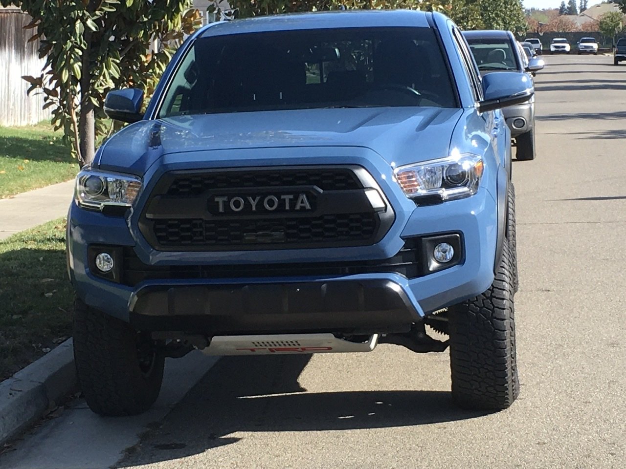

    this shows how much they will stick out.

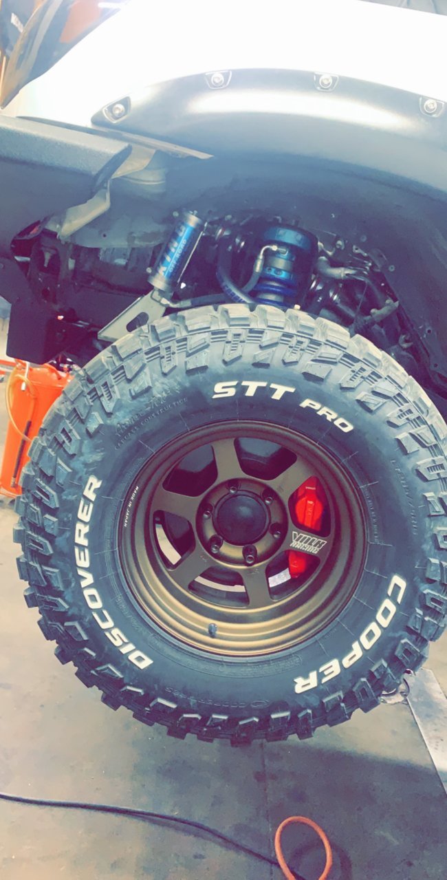

    Rays for days
