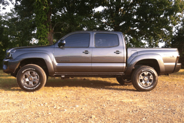

    My 07 that I traded in

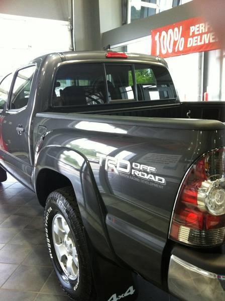

    My new truck at the dealer waiting to go home

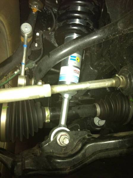

    Bilstein 5100s installed

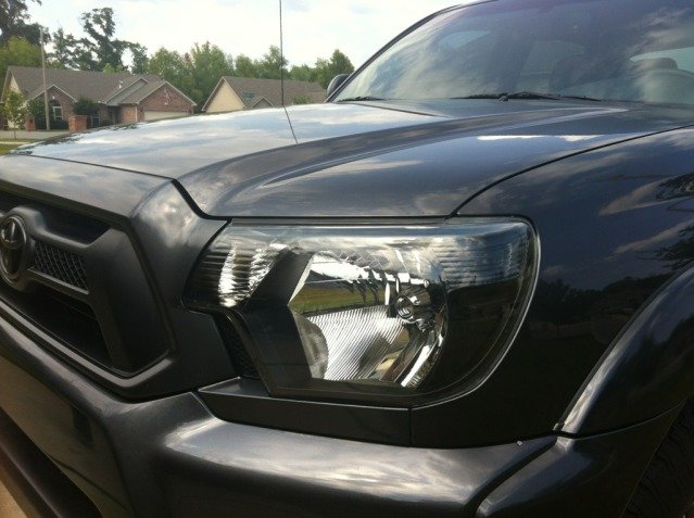

    Looks real good man! What method did you use to color match your handles and mirors?

    I roughed them up with 420 grit,cleaned with rustoleum wax and grease remover, sprayed with 2 coats of duplicolor adhesion promoter, 3 coats of duplicolor perfect match MGM paint, and 4 coats of duplicolor perfect match clear.

    Looking good, did you changed the headlights? If so will be interested on the factory ones

    Thanks, those are my factory headlights with the BHLM. I don't think there are any aftermarkets available yet.

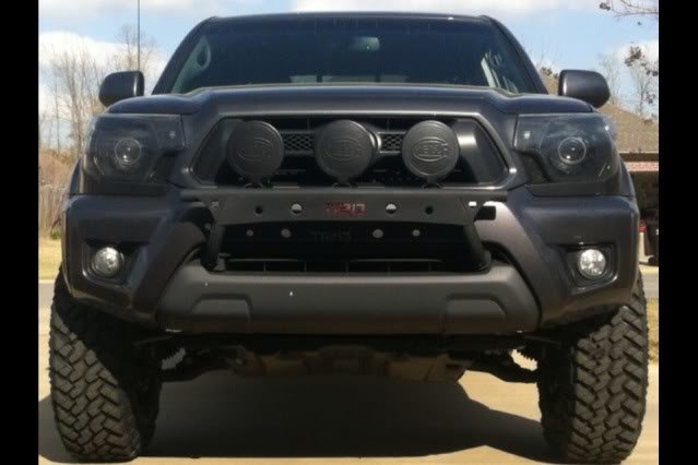

    What paint did you use on the front valence?

    Krylon Fusion flat black. It's almost a perfect match to the black on the grill.

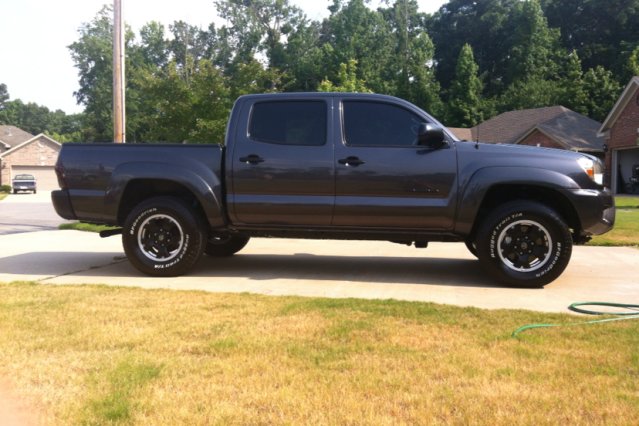

    hows your wheels holding up with painting them and how'd you do them. I was going to do my wheels but don't want to do plasti dip. I'd actually like them to last.

    They have held up good, no chips whatsoever.
    I sanded them with 420 grit, cleaned with wax and grease remover, sprayed with self etching primer, and then painted.

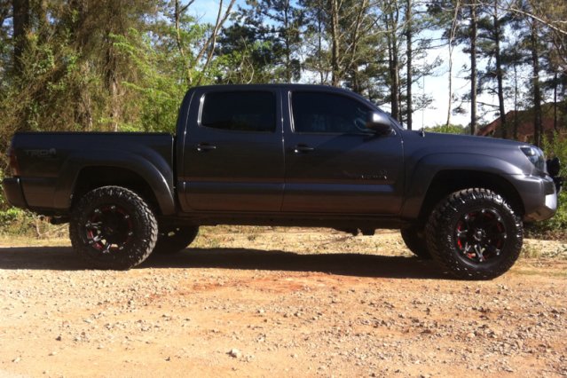

    Are you just running the Billies up front with the stock coils and UCAs? if so how does it ride and whatnot? Thought about doing this same lift.
