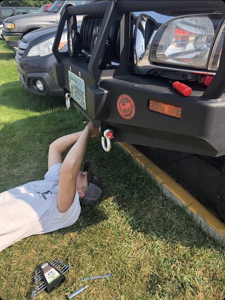

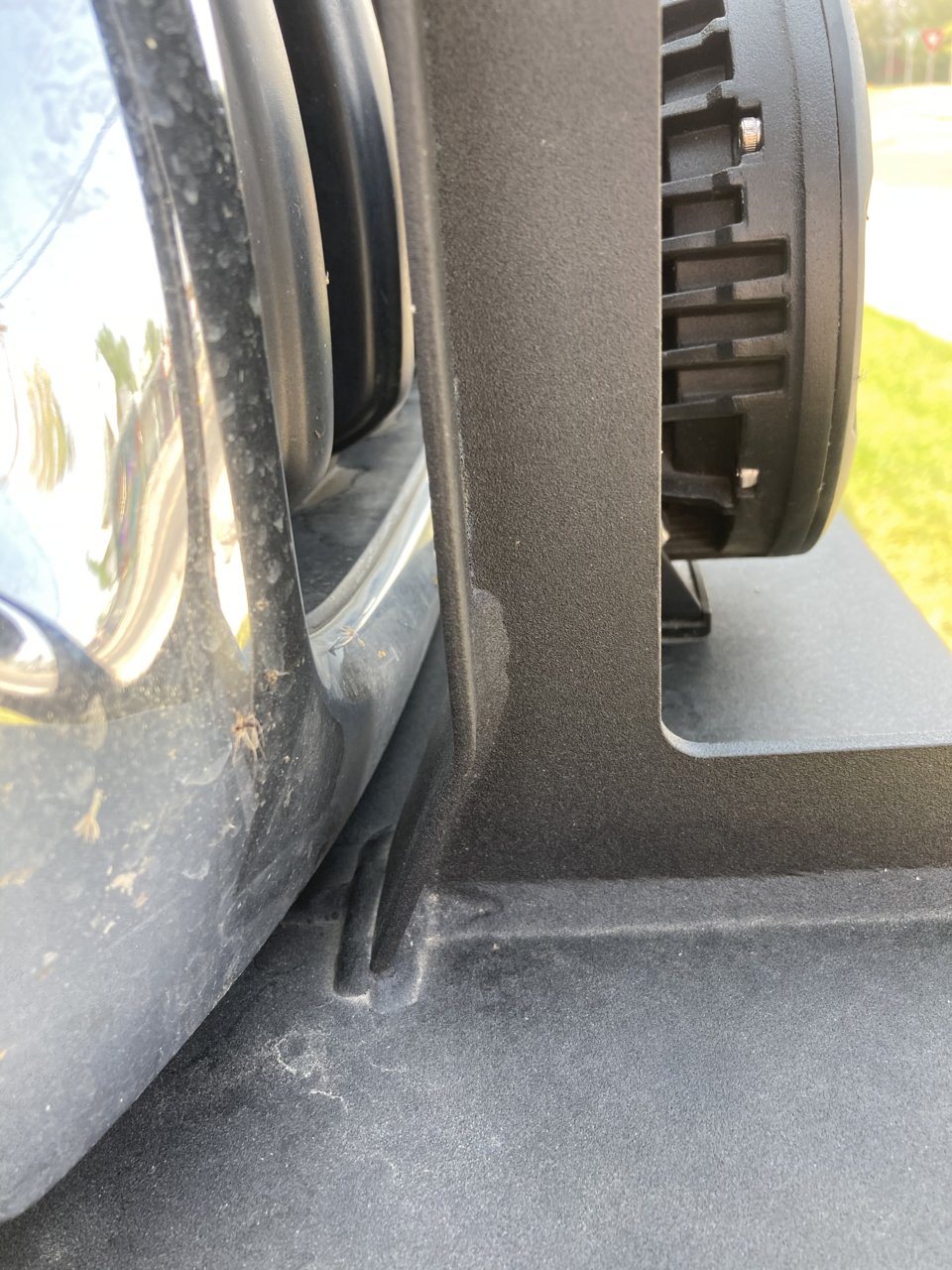

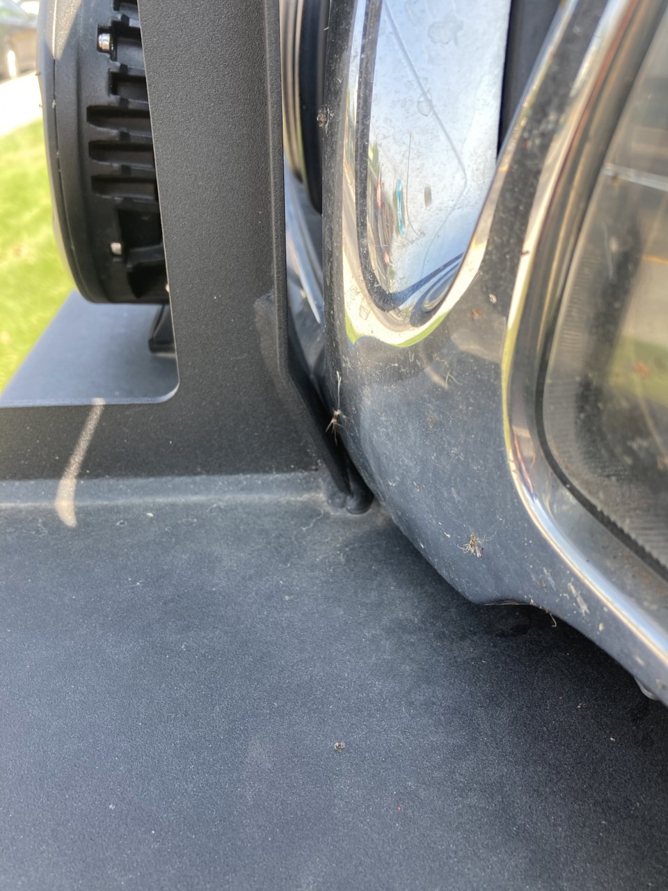

    loosened up the bumper bolts yesterday and fixed the alignment after hitting that deer the other night. not perfect but it'll do. I also fixed the antenna stud with a deadblow hammer. turns out it wasn't anything a little brute force and ignorance couldn't fix:thumbsup:. Truck will look way better once i can get the replacement trim piece painted and installed. fixing it in the dorm parking lot sucked though!
    this is how the supports for the bar were sitting before:
    Driver's side (where I hit the deer):
    Passenger Side:
    I didn't take an after picture but they are way more even now. all it took was loosening up the bolts connecting the bumper to the brackets, yanking on it, and getting a buddy to hold it while I tightened the bolts up. the pannel gap was also off (higher on the driver's side) so i fixed that too. i'd hate to have seen what might have happened if i hadn't had the bumper though... likely more damage than i could fix in an hour in a parking lot with some basic hand tools...
    and the finished product: good from far but far from good... still, she's straight enough for the girls I go out with:D.

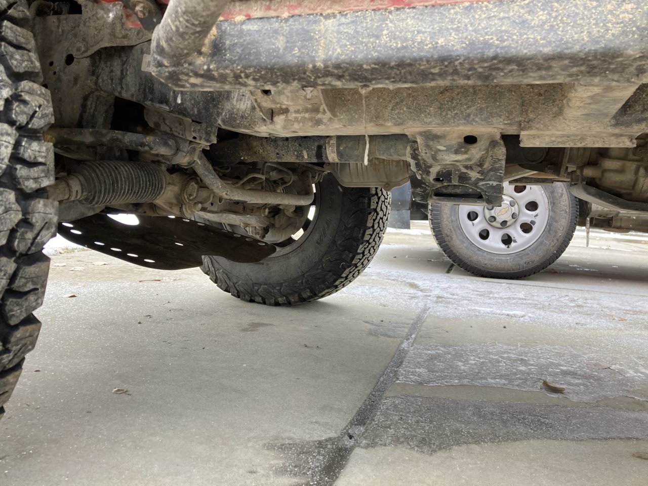

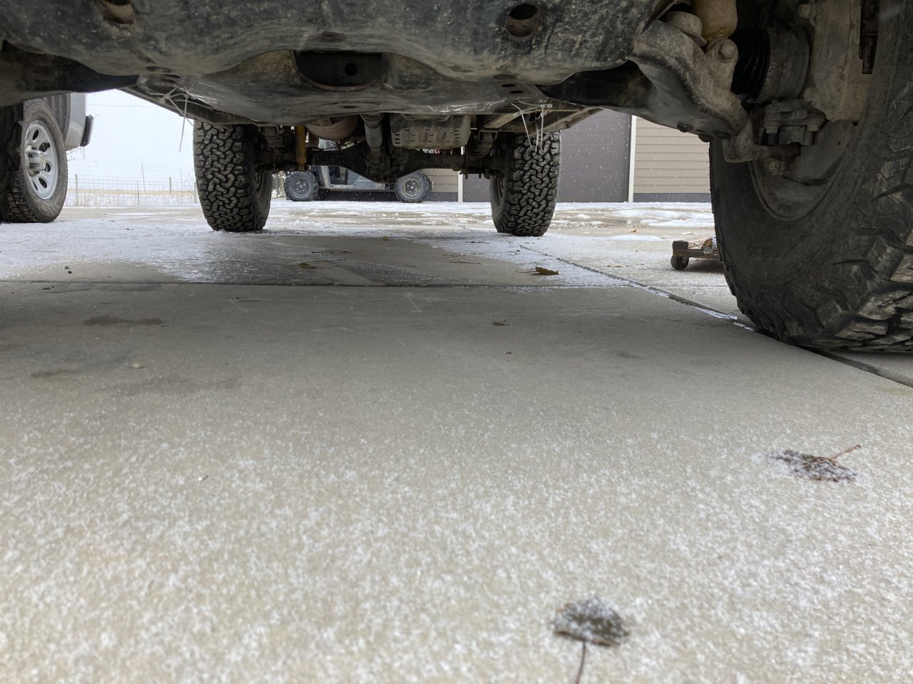

    Well, noticed that my skid plate was hanging on by a thread yesterday while hunting at a friend's property about 2.5 hrs from home:confused:. not sure when it happened but it looks like one bolt backed out and the other had the weld-nut shear off. whatever the case, I crawled under there and fixed it with some Zip ties for the time being. not structural by any means but it should keep it up and out of the way for a while. Don't anticipate i'll be wheeling much over the next couple of months anyways so it shouldn't be a problem. looks like it might be time for some new skids after that tho. Any input on what kind would be greatly appreciated. I was going to build my own but right now I don't have access to a shop or most of my tools and I won't be back at my parent's house in WA long enough to find time to fab some up. heard good things about budbuilt and skid-row...
    f*ckin mint!
    also, while i was under there I noticed that my driver's side CV boot was leaking. not a full on tear yet, but There's a definite leak and looks to be some dry rot on the boot so it may not be long for this word. whatever the case, it should be good to get me back to WA/OR for the holidays and then back here. I'll deal with it then. Not sure whether to re-boot or just get new CVs and keep the old ones as spares. also need to do the front brake lines and UCAs so that might happen at the same time. I'll need to ask around to see if I can get a buddy to lend me their garage.
    other than that truck's doing good (been a while since i've posted on here), just passed 165K last night on my way back from hunting. looking like i'll do an oil change and a tire rotation here soon but that's about it.

    Hello, nice truck. I have an 03 that I just got skids for, front and belly pan that extends all the way back to the gas tank. What maintenance would you recommend before putting belly pan on? TIA

    I would say that a full fluid replacement in the engine, transmission, t-case, and front diff wouldnt hurt since you have all the stuff off. other than that if nothings broken then i would say that there shouldn't be anything else to do. I would also keep in mind if there's any maintenance or fixes that you've been putting off but will require getting to components that will soon be covered by the belly pan (ie. speed sensor gear replacement, bleeding the clutch system, etc.) then I would say get that done as well.

    replaced the bolts in the skid plate today, the threads are pretty crusty and they are cross-threaded as hell but they should work fine. a bit of improvised threadlocker:D... I just went to Ace hardware and picked up some M8 0.125 pitch 25mm bolts. Still want to get new skids sooner than later, but at least the skid plate isnt being held on by zip ties anymore. I also changed the oil and rotated my tires. Wish I had taken more pictures but I was paying for a shop rental by the hour so I wanted to get stuff done as quickly as possible.

    you should be fine on oil change tbh. most aftermarket skids will have a cutout to drain oil since it's such routine maintenance. it's all the other fluids that I would worry about getting done since they'll be a PITA with the belly pan on.
    yeah, anti-seize makes sense on such a high-exposure area when it comes to road salt, water, dirt, etc. i didnt do that cause i've had a bunch of issues with the bolts backing out (second time!) so I said screw it and just did it. probably not recommended but hey... it works right? if you're between that, I would say use anti-seize and tighten the bolts down to whatever torque spec they recommend. those weld-nuts aren't the strongest when it comes to reefing on them but I would trust the manufacturer instructions, then adjust accordingly if you end up having issues. just my .02...
