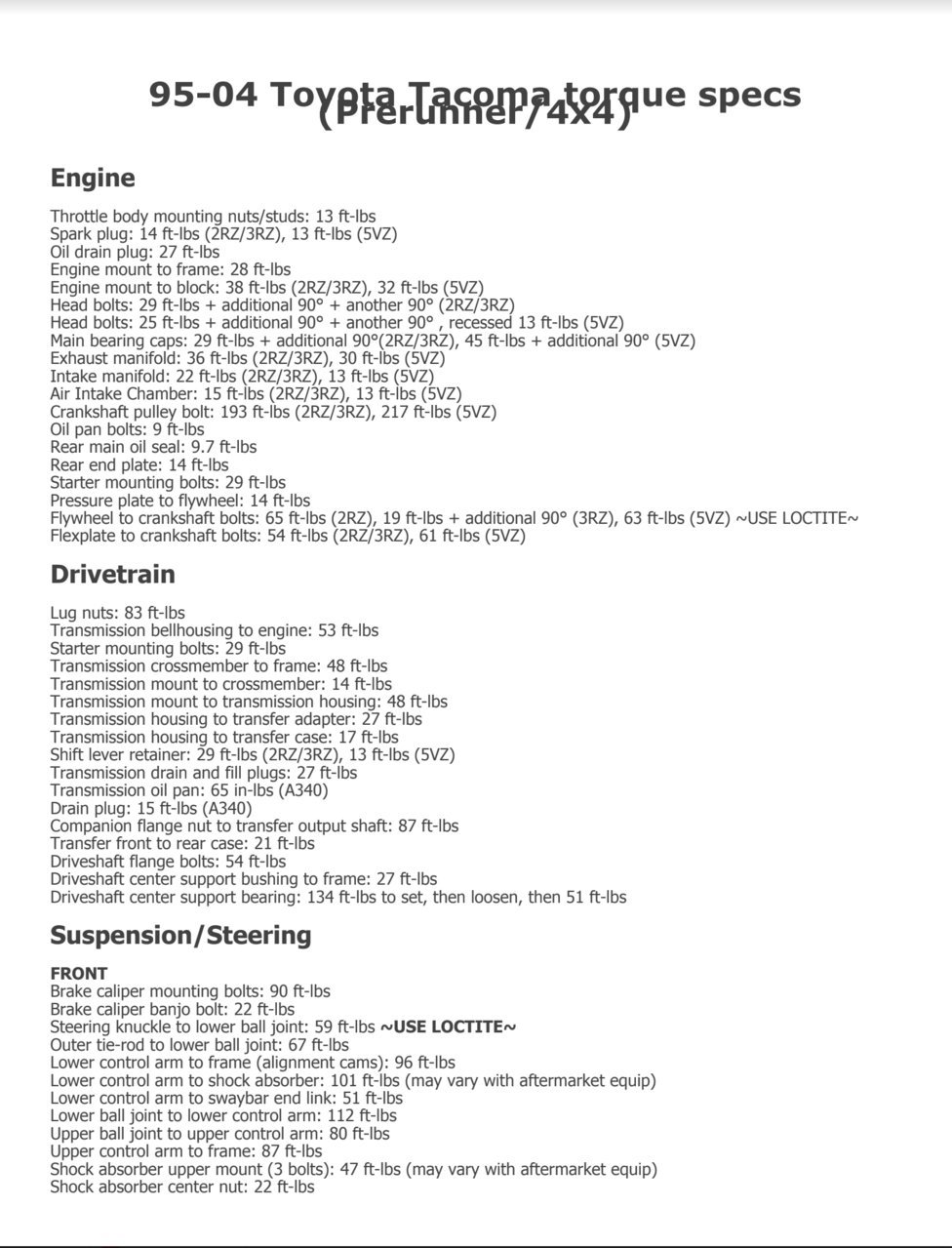

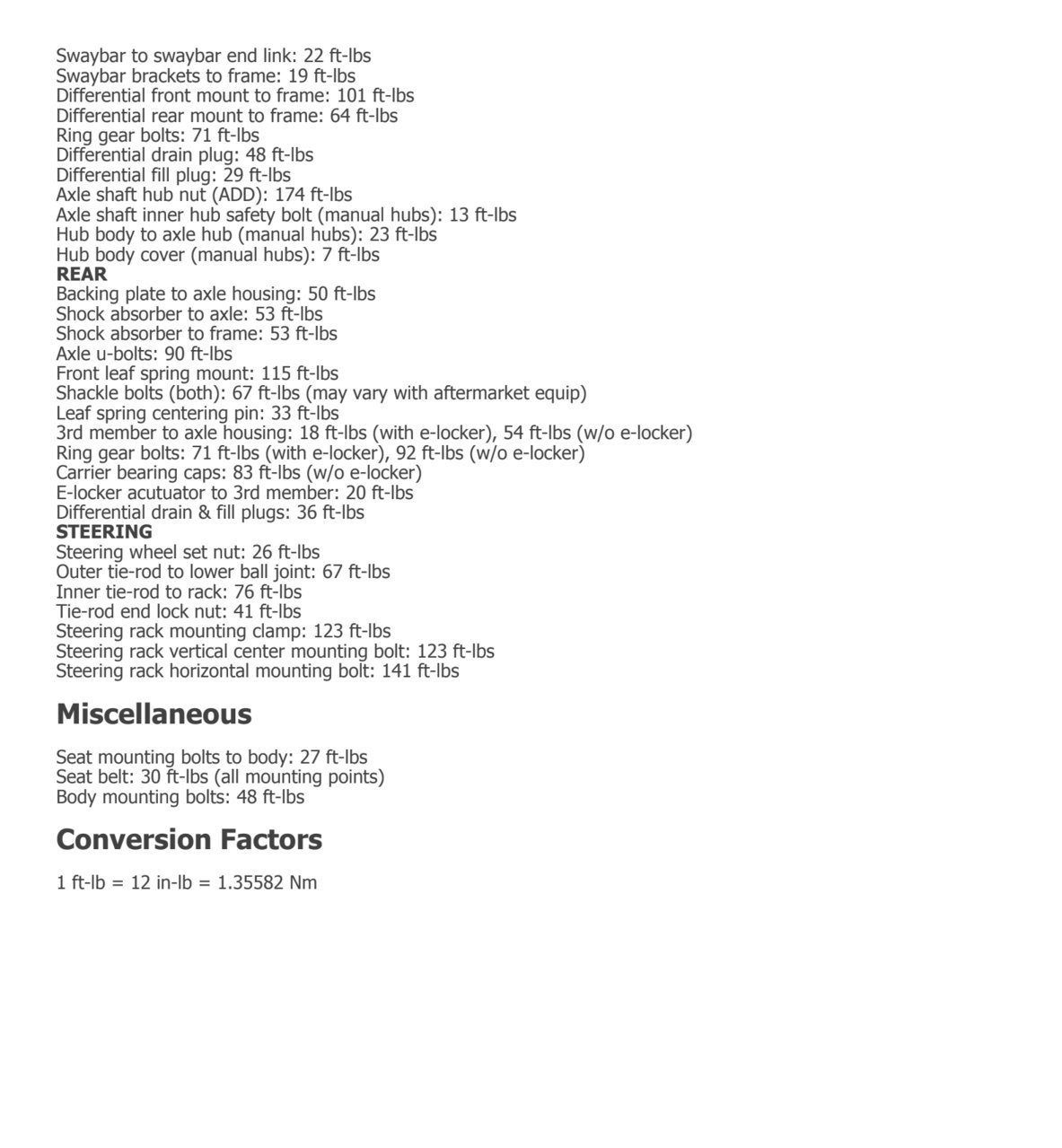

  16. Jul 8, 2019 at 8:38 PM
    #36
    eon_blue
    Mar 4, 2016
    #180213
    70,112
    Azusa, CA
    Here's the torque spec guide for our trucks, I have this printed out and keep it in my truck so it's handy when I need it
    ticky19, jin36, Sklar and 7 others like this.
