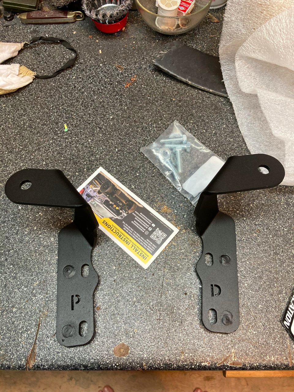

    CBI ditch light brackets came in today. definitely a lot beefier than i was expecting! still not sure what lights i want to get, the powder-coat needs touching up in a couple places but i'm hoping to get these on tomorrow sometime. think i'll have a better idea of what lights i want when i install the brackets. I really like the S1s but i'm still not sold on the 1 LED thing, seems like it'd be more useful all around to have the 2 LEDs that the S2 has...

    Installed the CBI ditch light brackets today, it was a pain in the ass to get to the bolts with the fender still on but i made it work... 1/8th of a turn at a time:D. i went to the home depot and bought a couple of 12 and 13 mm ratcheting flex head wrenches, but they didn't fit so i was back to the standard non-ratcheting wrenches:annoyed:. thanks to @Yetimetchkangmi for pics of his install, made everything a whole lot easier.
    used a piece of wood to shim the fender up so i could get to the bolts, was a little worried about the pannel gaps afterwards but they closed up nicely once i put the fender bolts back in and tightened them down.

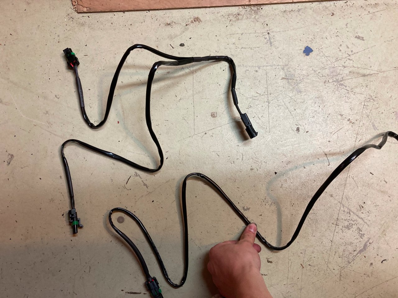

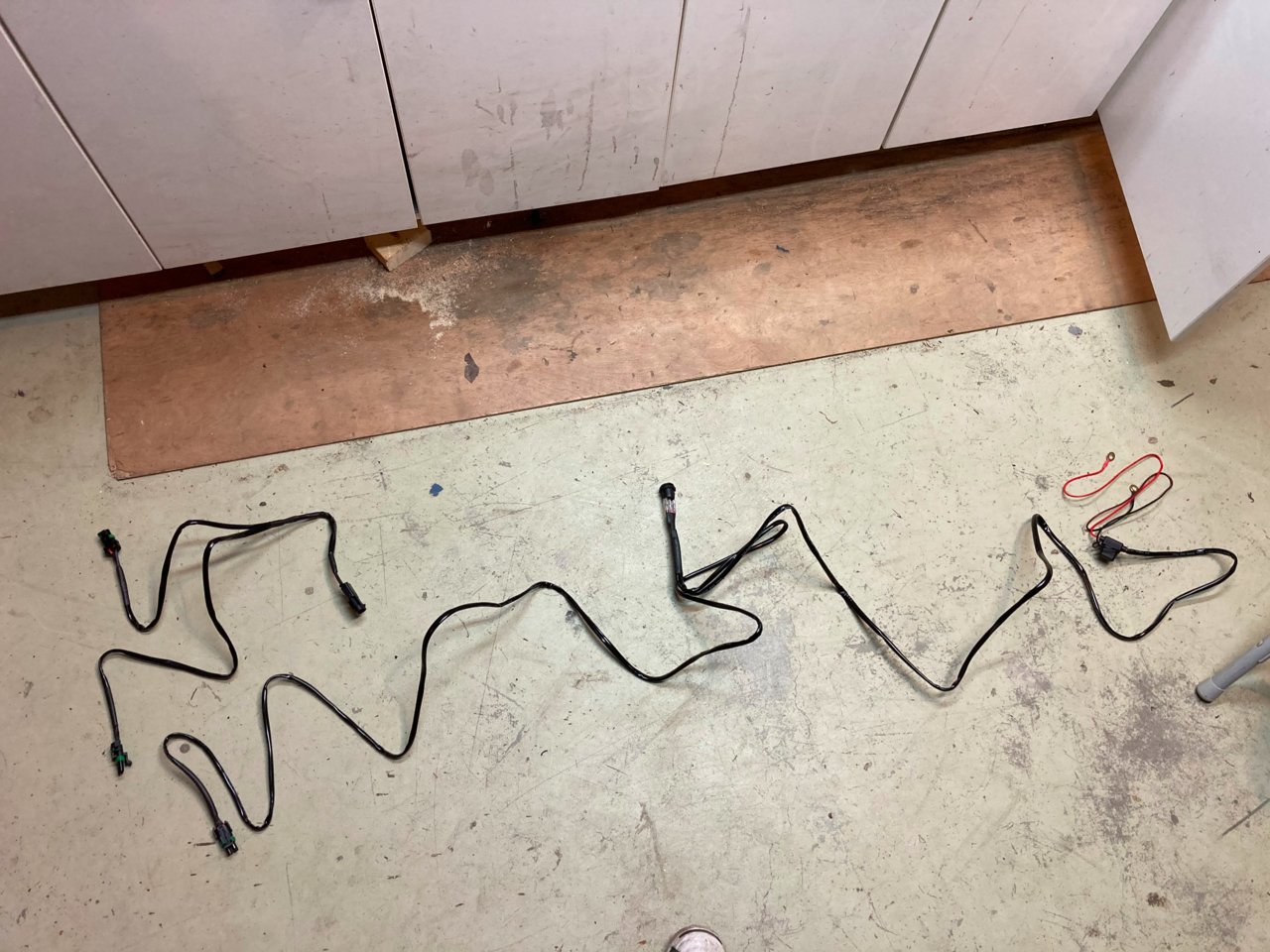

    Did the S1's come with switches and a relay?

    yep, came with everything you'd need to get it set up. i've already got an aftermarket upfitter switch system so i'm gonna cut the wire right here but i'll use the plugs from Baja Designs. upload_2020-6-24_18-59-34.jpg

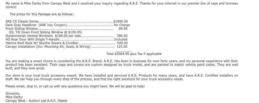

    so I did some digging in my emails and I found a couple of old estimates on ARE canopies from Canopy West in Everett WA. they're all from about a year ago but I can't imagine that the pricing would be any different now or between dealers. here's one from July 8th 2019:
    This one is pretty much exactly what i'm looking for. it's got a flush roofline so it'll look cleaner than my high rise one, Vented Windoors so i can get at stuff from the side and still get a breeze when i'm sleeping in the back, a sliding fold-down window (not included on the estimate but if the upgrade is still only 10 bucks i'll take it), and a carpet headliner. I'll wait on the roof rack but i'm planning on asking if they can attach the tracks for me so i can add one later. if not then i'll just add the tracks too whenever i can afford a roof rack. The headliner is free in this quote but ARE is doing a promotion that lasts the whole summer and says that a headliner is free on any CX series cap. i'm planning on going through Big Sky Toppers in Bozeman and i'll order it so that it'll be in around early September. Late enough to still enjoy a topless truck, but early enough to be on before the snow hits. still not sure on trading in vs selling my old top. LMK if anyone in the seattle area is interested. not to turn this post into an Ad, but i can also deliver within a couple hours for a fee. i'll also be down in the Portland area towards the end of July so any of you northwest Oregon TW members, LMK and i'll bring it down will deliver as far east as Hood River and as far south as Corvallis. the only thing about trading in that might be nice would be if they offered any sort of discount on a new cap with a trade in... and the ease of not having to deal with listing it and haggling over it might be worth it too. it all depends on what they think they can give me for it. This is kind of the look i'm going for, credit to @RSB for the picture. this is from the listing when he sold his truck:

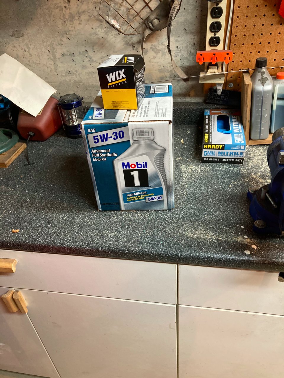

    picked up an oil filter for my soon coming change. I was going to try and wait until after a camping trip i have planned in july, but i'm driving way more than i thought i would so that's not happening. I've had the oil for a few months as a found a killer deal on it at Costco. now the time has finally come to use it up!

    changed the oil today. A complete pain in the ass as usual. that oil filter's location is just downright stupid. i seem to have found the perfect way to get to it though with my Flex head ratchet, a 9" extension (3" stacked onto a 6"), and a U-joint adapter connected to a filter socket. made it as painless as it couldve been. I changed it at exactly 3k and the oil still had a lot left to go. not brand new by any means, but it looked like it could've gone another 1,000 miles. i think i'll do the next one in 4k.
