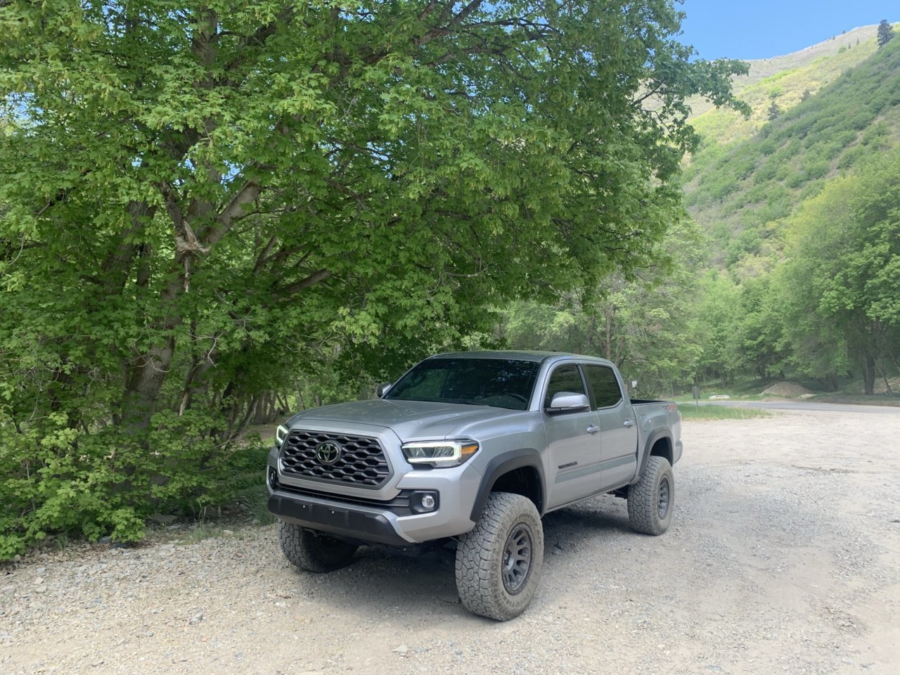

    I had 886 springs and 90000 shocks, known as OME's heavy duty line up, but with medium duty dakars. Rode perfectly fine once things were settled. I would 100% recommend new UCA with anything over 2" of a lift. Better for alignment, better angle, and stronger. I had SPC's UCA.
    Pic because I miss it.

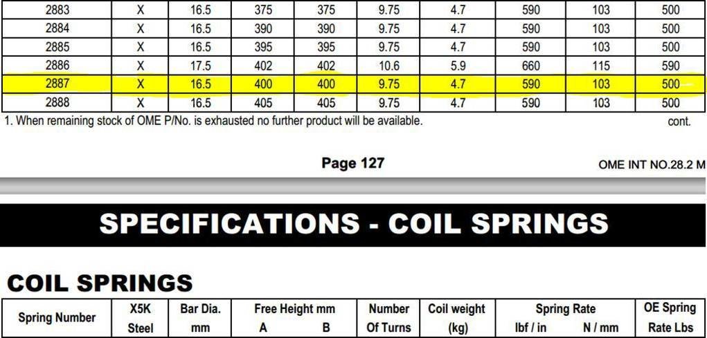

    Can these coils be adjusted to a lift that is less then 3"? The website says 0"-3" I've just had a hard time finding information on how that's achieved.

    No, they're not a fully adjustable coilover.
