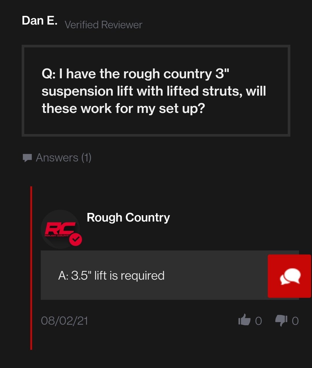

    I'm not disagreeing with you there (though I'm not one to cheap out on lights, I'm a lighting nerd lol). But I doubt RC would put out a product that is unsafe that would potentially ruin their name. Looking at the install instructions on the 3.5" leveling kit it says to "align to factory specs". So I would assume it improves caster and ball joint angle like every other performance UCA does. My current set up is 6112's w/ 600lb springs (5/4 clip setting but still getting lean, I only gained a little over 2" lift after settling), OME Dakar Med leafs, B110 5100's in the rear. I want to step up the front spring rate to avoid the lean, but I'm not doing that until I get UCAs.
    Ya, I'm sure it's to cover their a** that they say ONLY for 3.5" lift so normal RC buyers aren't confused.

    I agree, the risk reward isn't there for them to risk people's lives.

    Oh right, 3.5in lift required. Can you tell that's not my thing either? :rofl:

    I do find the “only fits with 3.5 of lift” as someone else noted, goofy as hell too. Either that’s just them not knowing their product or these have some whacky specs. 3.5” isn’t a popular lift number, 2.5-3” captures most people out of the range of OEM UCAs. It’s either that or people go to 4-6” drop brackets.

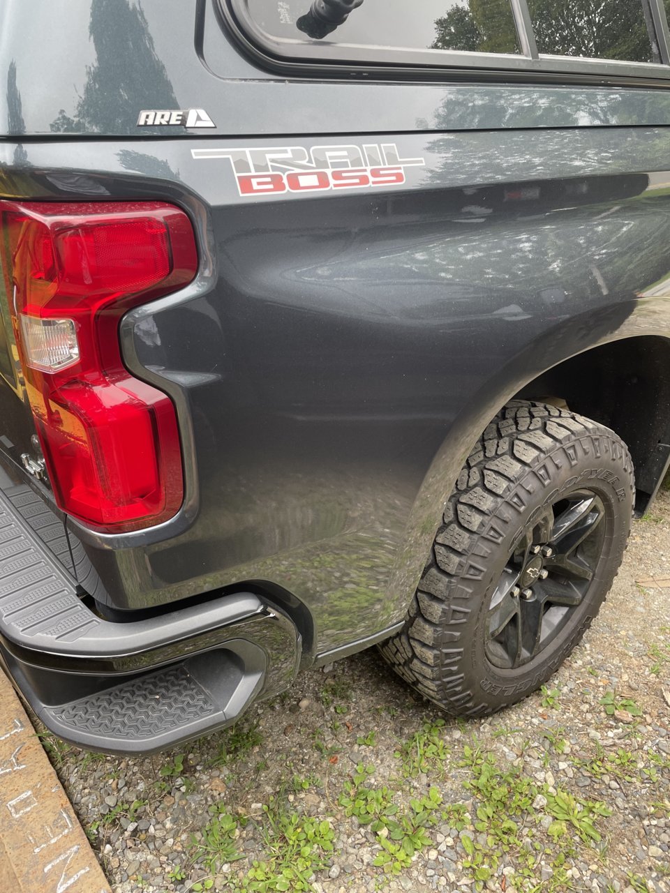

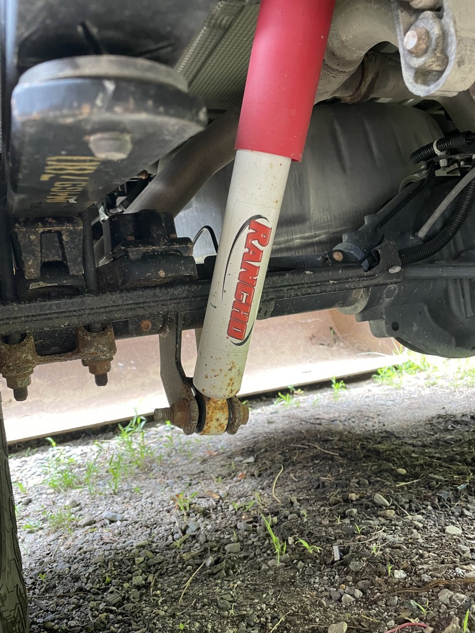

    You may be mistaken here bro. I've got a 2019 Trail Boss in the driveway and the shocks are Rancho, not RC.
    7D3E9A55-9F44-42FF-896A-64DDC549FC41.jpg BDB4DFBE-6BC9-4CC6-B4C7-375BEFD5B73A.jpg

    You're right! My bad, I looked on my phone and all I saw was "sealed" in the options and didn't see that it referred to the inner uniball. OOPS! That's a good point. I would assume, not knowing the ID, that you could put OEM or OEM replacement bushings in. As for the ball joint, I don't see a replacement part number. Though I did email them about it, we'll see what they say.
    Wel, the OEM UCAs are stamped steel, have limited range of motion not allowing for lifts higher than 2.5" and they do not change the caster when lifted.
    Oopsie daisey, my bad! I'll correct my previous post. Though I haven't been a fan of Rancho in the past either, I've replaced many with 25k miles on them that were blown. But I'm sure GM engineers worked with Rancho for longevity and hopefully it's not going to be an issue.
