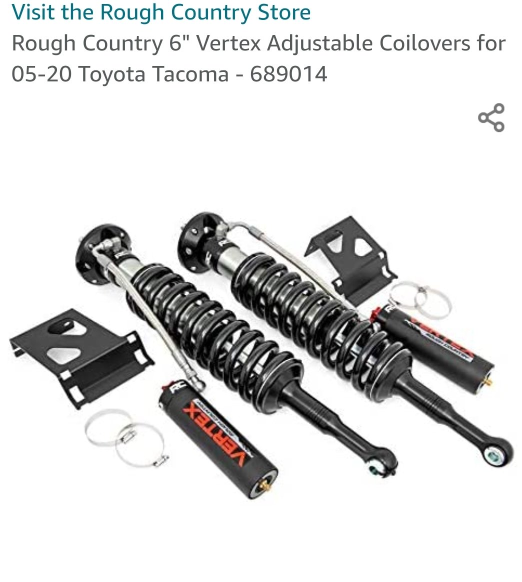

    I'm about to purchase this. I been doing my search and I love everything about it. I even contacted rough country to ask if it will handle my 220+ lbs bumper and they said it will. Anyone here using these and how do you guys like it?

    6" of lift... thats not really possible without drop brackets and custom knuckles

    I'm actually looking at the 3" didn't notice I screen shot the 6"

    3.5 inch lift?

    Yes, a lot of the 3rd Gen guys say it’ll settle to about 3” of lift, instead of 2.5” with the 3” version.

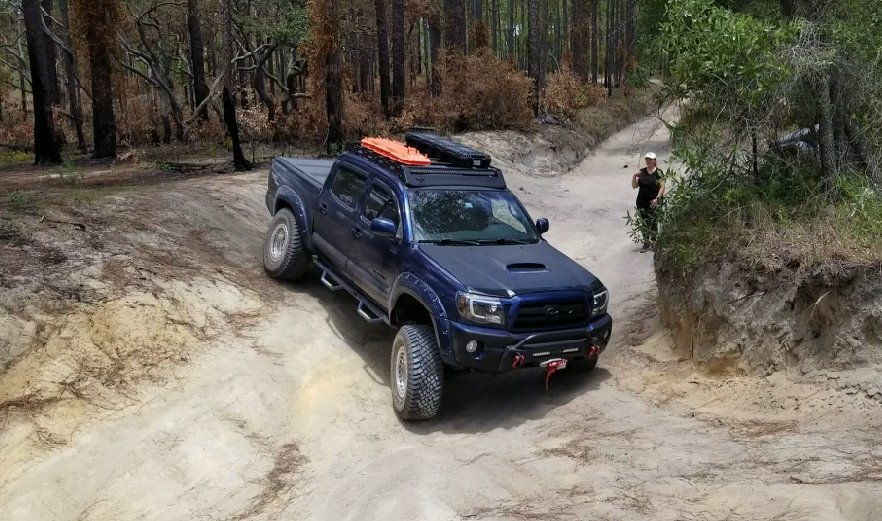

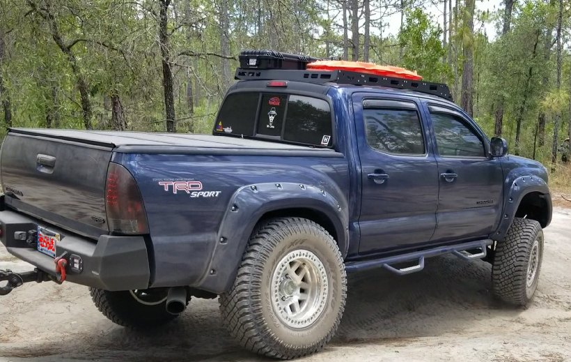

    I have the front and rear 6" version with the 6" lift. I absolutely love these. I have them set on the softest setting with AllPro standard leaf springs and they soak up the bumps like nobody's business on and off-road.

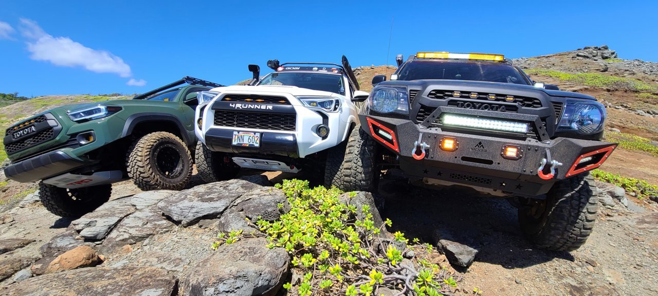

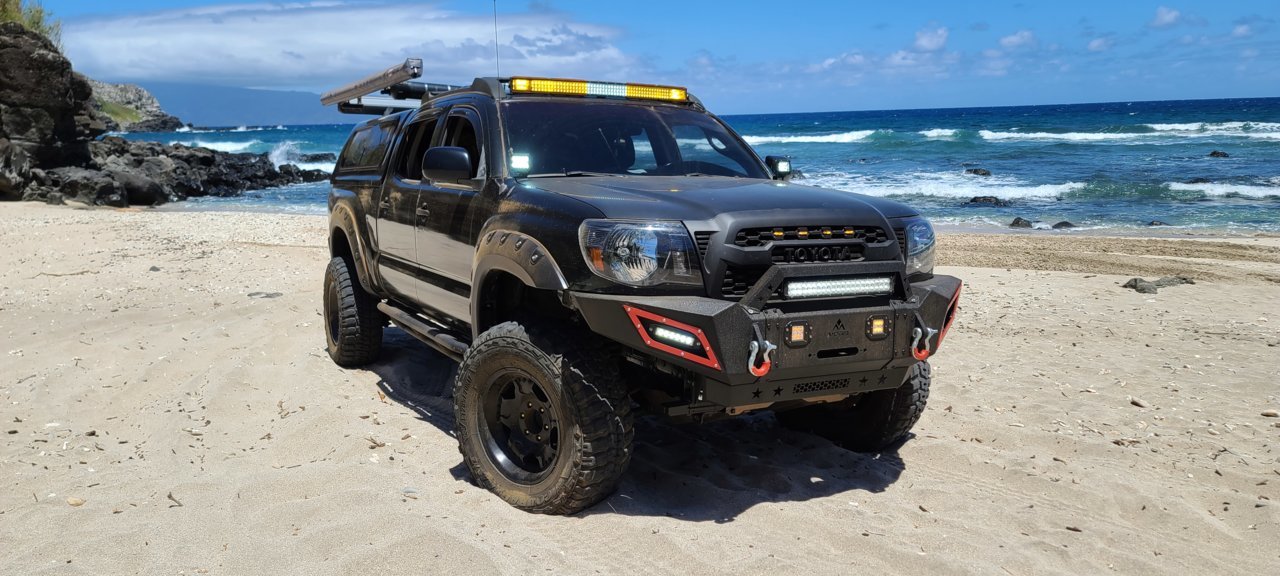

    lift and tires specs??? Great looking truck!

    Belstein 5100 with 885 ome coils set to 3rd clip 3.5 lift. Tires 33 or 285/70/16 1.5 wheel spacers.

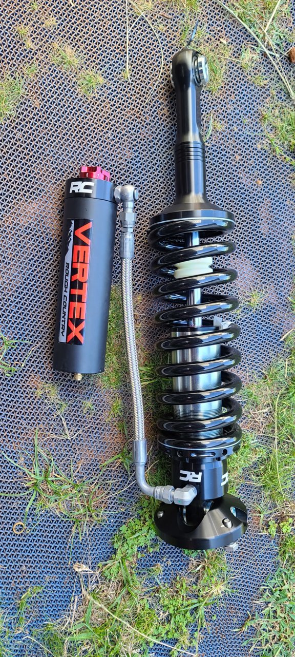

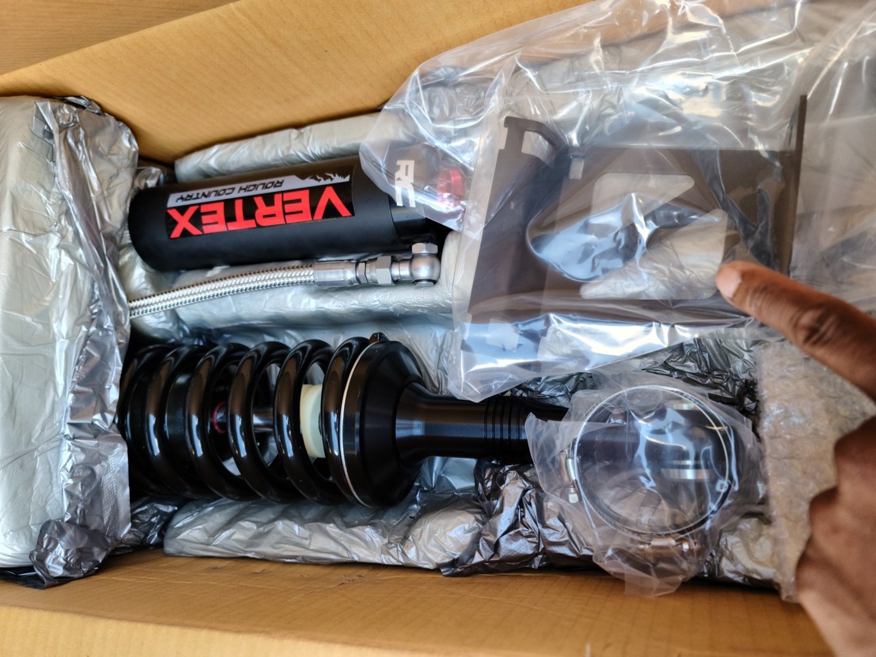

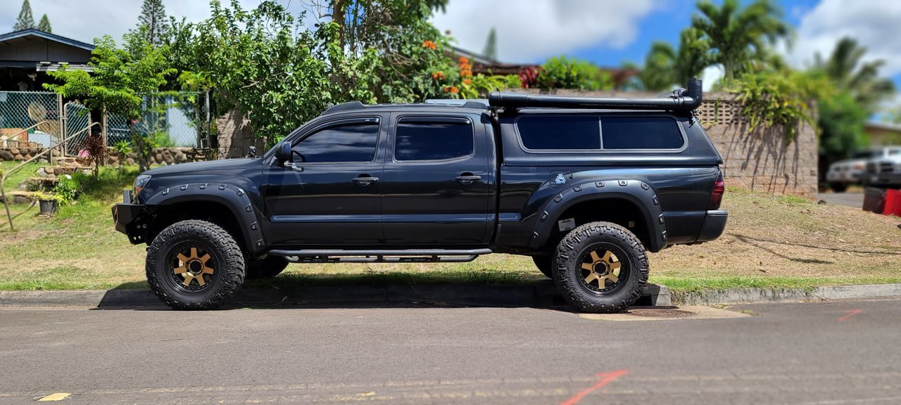

    Update on my vertex that I ordered. Just installed it. After installing it took it for a drive and it drove nice but kinda soft lots of body roll. I change the settings to #6 and it's was little stiff. Went back one click down to #5 rides pretty good so I'm staying on that settings for now. So far I'm liking it better than the 5100 20210909_125652.jpg
