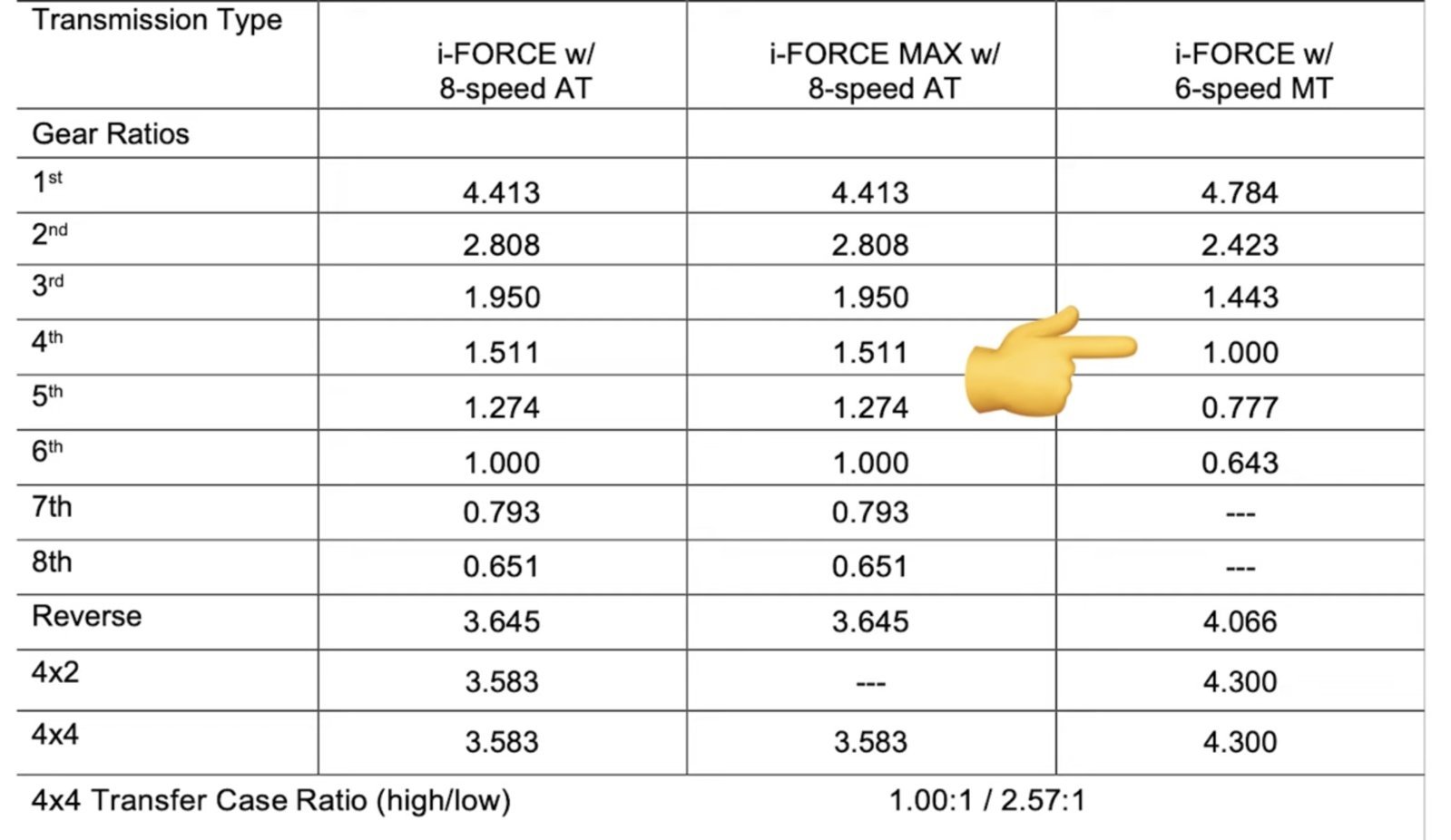

    Another video confirmed 5th and 6th are 0.777 and 0.64. Basically confirmed at this point to be the RC60F in the new truck. Obviously still need official confirmation, but it’s the only thing that makes sense.
    I really hope it has the right input shaft!

    I’m following the 4th gen transmission specs. Trying to see what it has to see if that would be an alternative swap option as opposed to buying the Mexican or Asian Hilux transmission and doing all the teardown and reassembly of it.
    The ratios all match up to the RC60F that Jowett bought. If it IS the RC60F, whether or not it will work will depend on input shaft specs (length/spline count). Likely the bellhousing would bolt right up.
    in other words, it seems like the new truck has the transmission we want. I want to confirm compatibility.

    Now we wait and see the actual trans details once they’re out. It certainly has the ratios we want.
