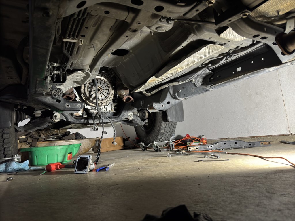

    After about 3 hours, the driveshafts, exhaust, shifter, crossmember and supports, and transfer case are all out. Transmission is drained. Wiring is mostly freed up from the transmission.
    Those top bellhousing bolts are going to be a bitch. Still working on the accumulator and disconnecting its lines. I have a feeling once that’s done; I’ll be able to lower the transmission more for a shot at the bolts. After that it comes out.

    I used judicious extensions and one u joint when doing a sequoia a while back. Top two bolts took just as long as all the others plus wiring harness combined

    It’s funny, the wiring harness took me forever but the bolts took like 10 minutes. I got to all of them with a 30” extension.

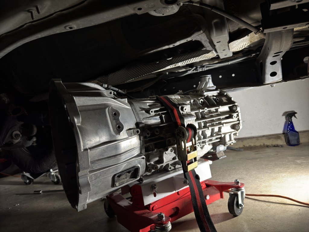

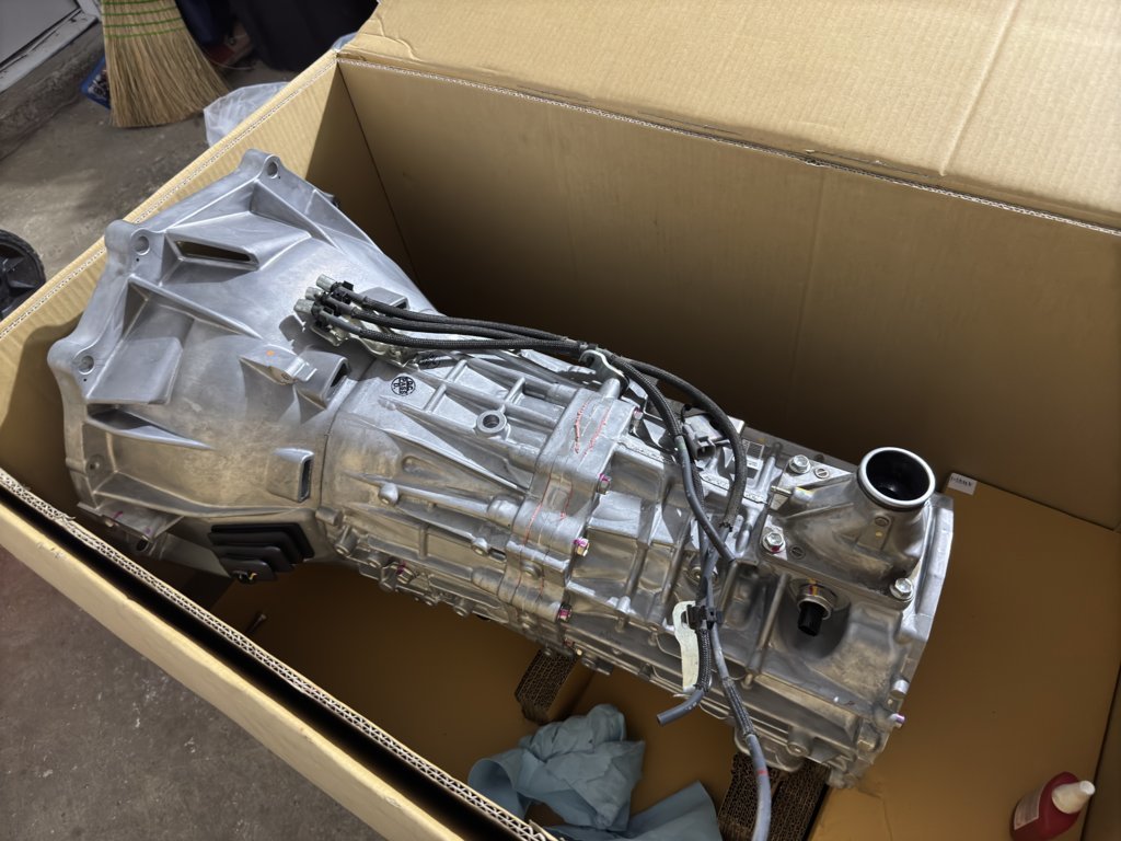

    It’s out, bellhousing is off. Had to jack the rear of the truck 4-5” above the dollies to get the thing rolled out from under the truck. No way was I going to try to slide the transmission out and the new one back in and try to heave it up onto the jack under the truck.
    It’s only 9:30 but I may be calling it a night, mainly because the next step is wrestling the new one out of the box and onto the Jack, which sounds heavy and annoying lol.

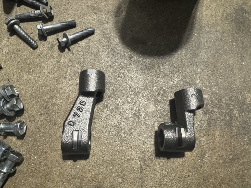

    Interestingly enough, the shifter piece is NOT correct. The short one is the one from mine and so I will be moving it over. They use a shit ton of red loctite on it, so I will be doing the same. Guess they don’t want it coming off.

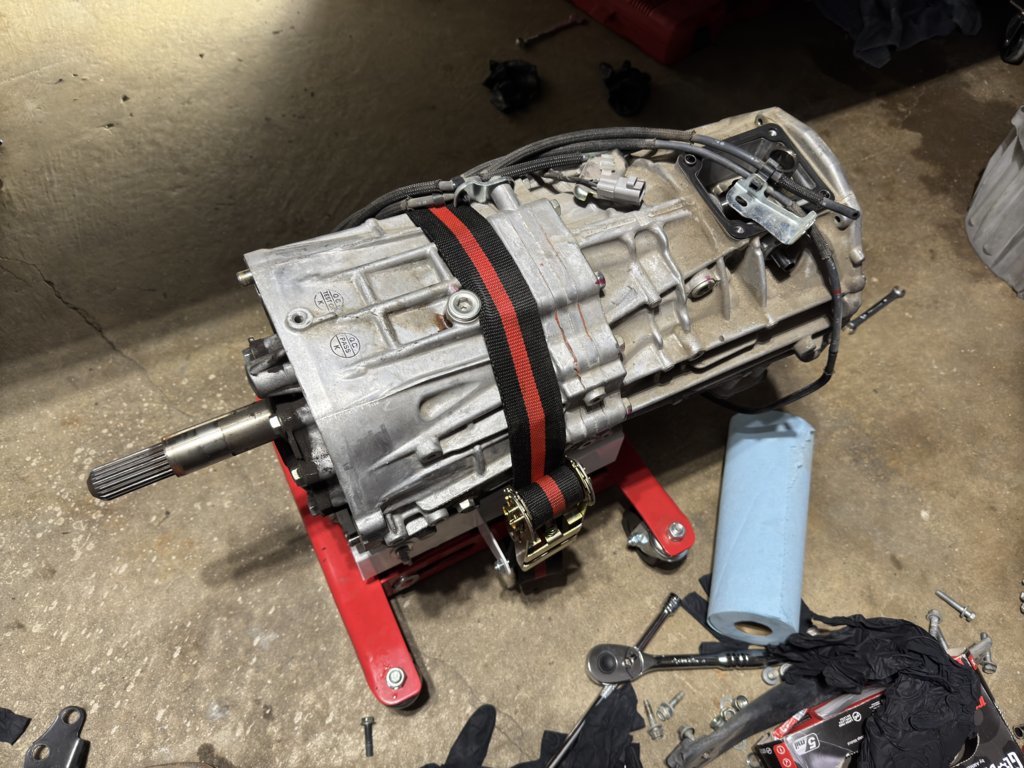

    Yeah, I’m about done now. I did pick up the old transmission off the jack and set the new one on there. Bellhousing still needs to be swapped. Since I want to clean the old, that will wait until tomorrow.
    Essentially, first thing in the morning will be the flywheel and clutch stuff. Then the bell housing, and then throw ‘er all back together. The flywheel and clutch will take far more of my time than I’ll want them to.

    It’s a good one, although my jeep transmission hates sitting on there. The Toyota doesn’t like it much either but it’s a lot better than the jeep. Both are aisin transmissions.
    It’s a lot better of a jack than the more expensive and heavier ones that have the flat plate with the adjustable arms to cradle the transmission and a crappy chain to tie it down that barely works or even gets tight.

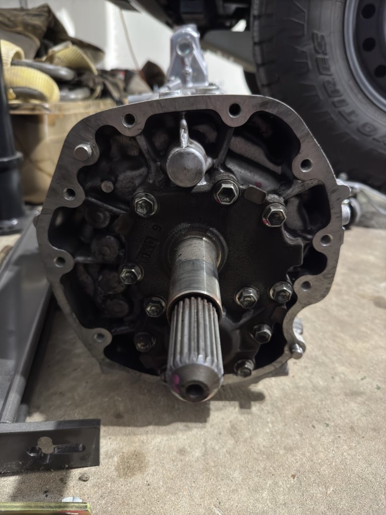

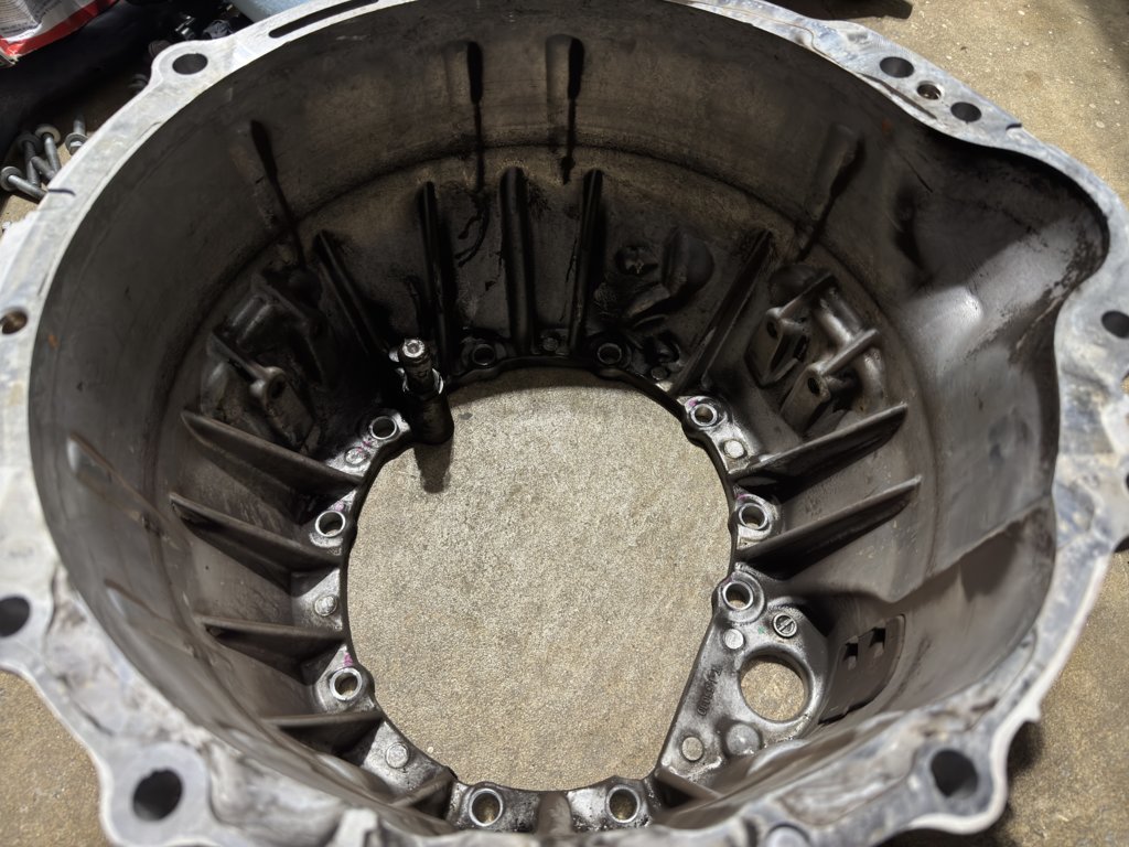

    I’ve called it a night. Last thing I did was remove the bellhousing that will not be used and then took front pics comparing the two. The only real difference in the front cover plate is the release fork support mount thread. I think I’m going to leave it and use the newer cover. Otherwise I’ll have to deal with RTV and such (I’m pretty sure) and I really see no issues with just using the 2024 version.
    RC60F
    RC62F
    I also did mount the slave cylinder and accumulator and my concerns about the hard line hitting the input revolution sensor are unfounded. The hard line clears perfectly fine with probably half an inch of space, so nothing needed there. Just leave the sensor so it can seal the hole.
