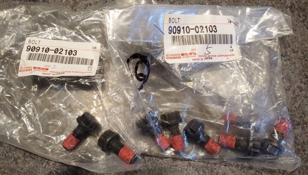

    As you mentioned the new bolts came with some stuff on them already. I also used the stock replacement bolts like you. Just put them in as shipped with no extra thread locker. Been good for 2 years so far.

    If not too much trouble, post pics of bolts?

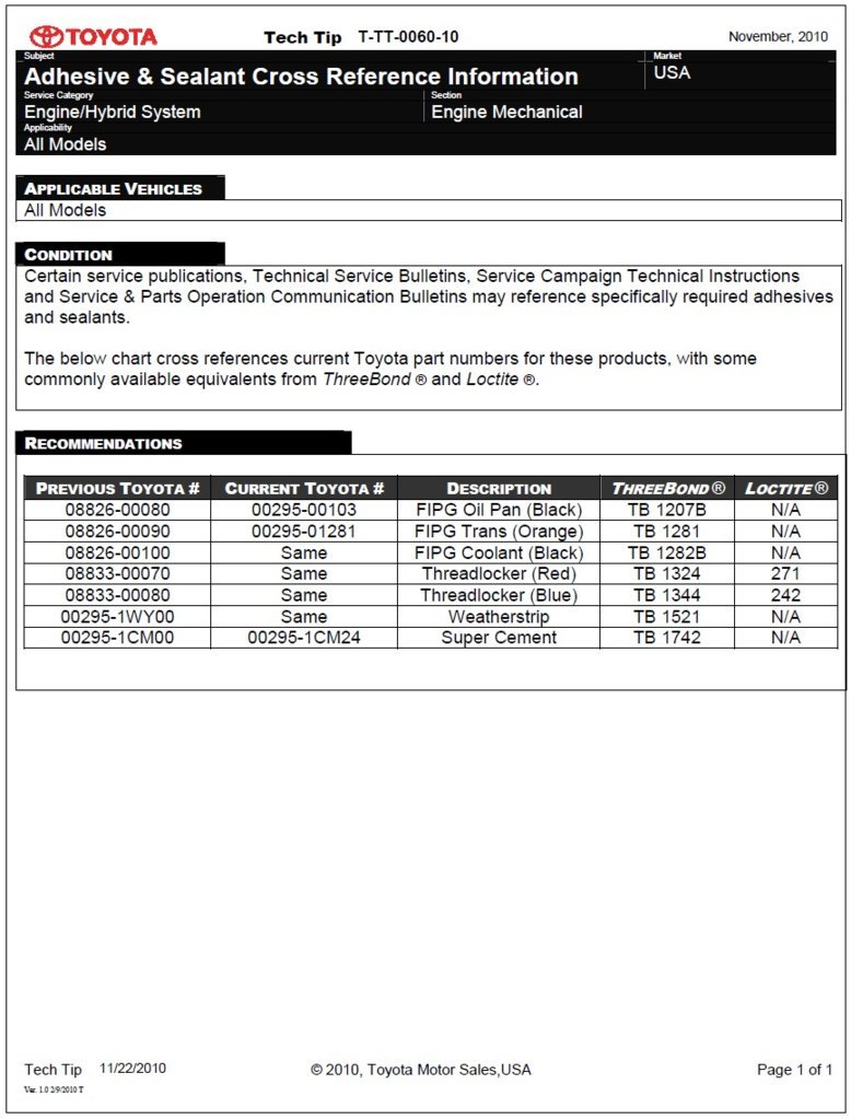

    Generally if they're already coated with sealer, you dont need anything.
    That being said, adding additional loctite sealer won't hurt,
    Assuming for a fact you know the flywheel holes in the back of the crank go into oil???
    On ford, some do, some dont...
    There's this, which confirms your 271 will be fine..
    https://www.cherishyourcar.com/loctite-on-flywheel-bolts/

    I'd like to think the pre-applied stuff would be all that is needed; but now you've got me second guessing myself, as I am about to pop a flywheel on with new hardware as well. I certainly don't want to have to go back in there over some omitted threadlocker. Perhaps this is guidance in case of fasteners that are being re-used? Perhaps we're over thinking it..

    What would applying the loctite hurt?

    with Ford, if the bolts come factory with a sealer around them like in the scenario, they are one time use. So it would never direct you to add loctite sealer but I know what you’re saying.
    Post a picture of the bolt with the sealer.
    I just wanna analyze how much sealer is on the new bolt, that should tell the entire picture if it’s truly needed or not
    CygnusX191 and Supr4Lo like this.

    we almost certainly are, especially considering supr4lo up above just installed his as is. I’m probably going to do a small bit of the 271 and call it good.

    Here were my bolts for reference

    Yep, same ones I got.

    You guys are overthinking it, won’t hurt anything but not necessary.
    Is it done yet…
    Hurry up!!!!
    Absolutely 2000%, not needed, good to go!

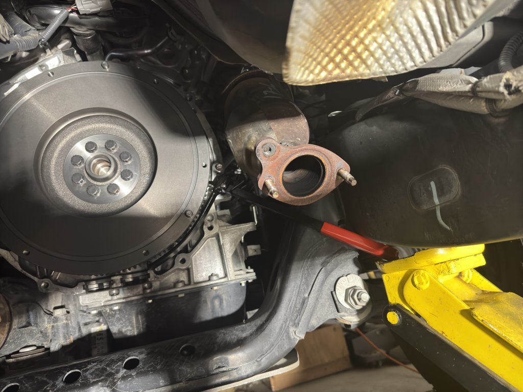

    Flywheel is on. Cleaned it off with dish soap and water. Torquing the bolts was not fun. The 22 ft lbs was easy, the 90° was not. Had to use some ingenuity with a flywheel holder and jammed it up into the frame with my floor jack to hold it. It worked. I called my brother to come out of the house to help hold the holder, but he was fighting for his life on Call of Duty, and transmission swaps take a back seat to that.
    The 90° is some serious torque lol, probably 100-120 ft lbs and not a lot of leverage to generate that. Anywho, it’s done. I did use some Loctite, although I definitely think it wouldn’t have mattered. It was clearly only red Loctite in the bolt holes and on the bolts originally. On the other side of the hole, there is some sort of metal very close to the hole. It’s doubtful oil even gets to this area, the ends of my old bolts were dry as a bone. But I used some Loctite anyways.

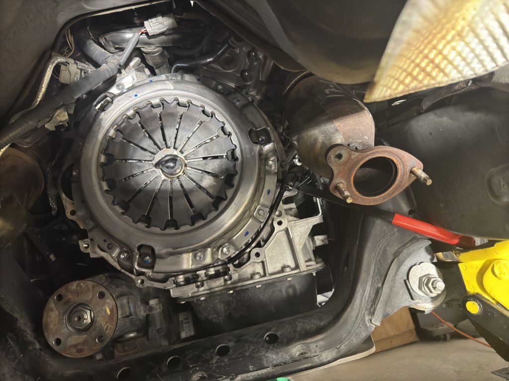

    Cleaned up the pressure plate the same as the flywheel, good old Dawn, water, and shop towels.
    Clutch is on. Alignment tool worked perfectly. Kind of a handful to get the pressure plate and disc up there with only two hands AND get bolts in, but it’s done. Torqued them to 20 ft lbs (spec is 14) because my wrench is old and handle has been left twisted many times so just adding in a bit. Interestingly, one of my old bolts was loose. Hopefully these don’t ever loosen up.

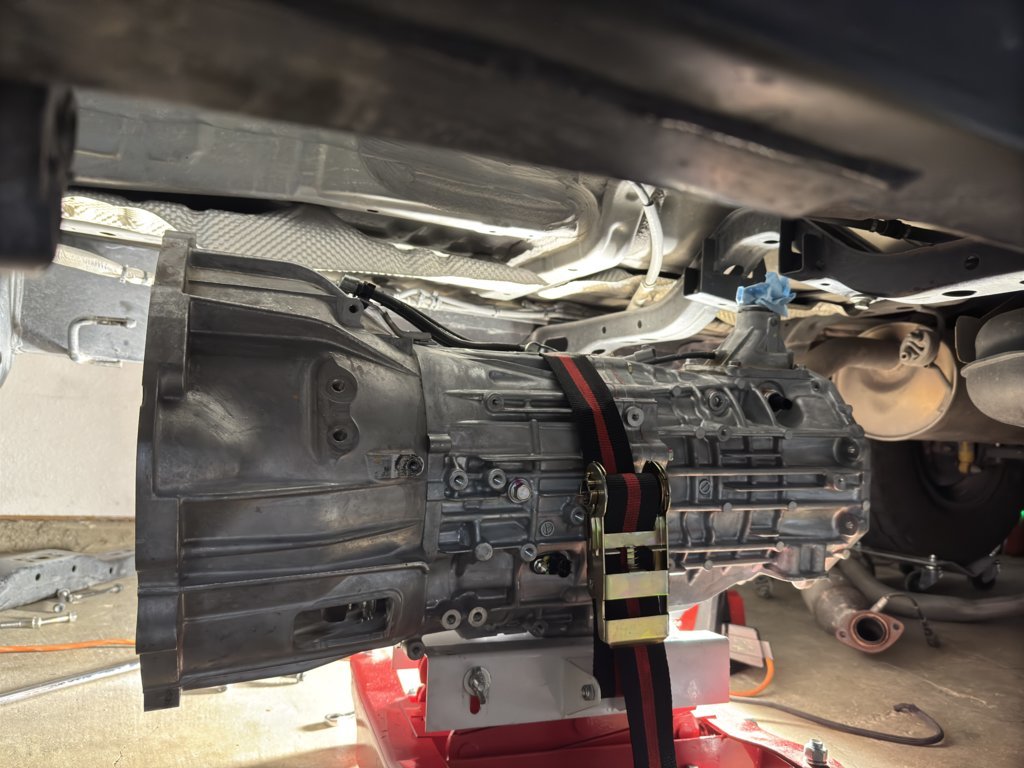

    With all that said, I think it’s time for the transmission to find its new home in the truck.
