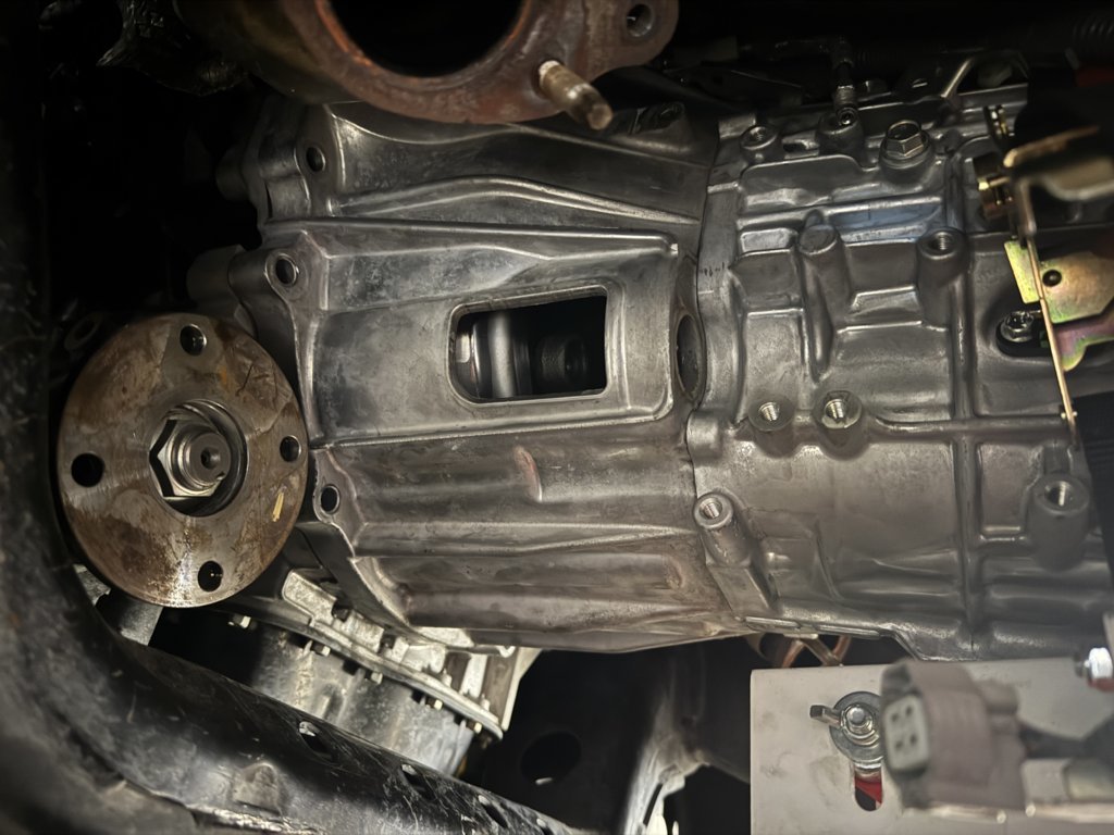

    We’re in! I struggled a bit with clearing the body, but it’s because the transmission wanted to rotate on the jack. Once I got it oriented up, it cleared the body and rolled right up. Then a little bit of fanagling and in it went.

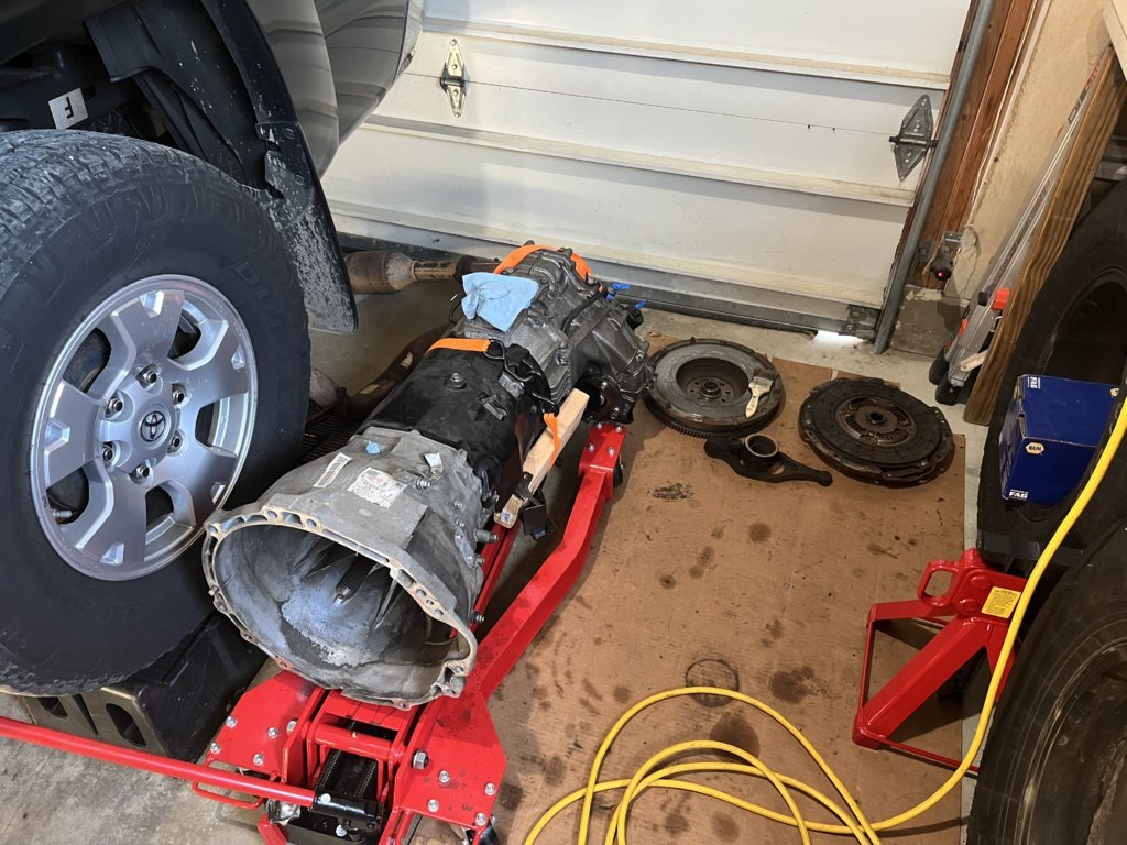

    Paused for lunch break which will be a while because I’m borrowing the neighbor’s car to pick it up. So far it’s going pretty smooth. The wiring harness sure is a bitch (the top bolt at the bellhousing mainly is the bad one) and the upper accumulator support line bracket bolt is a real biatch. Between those two I spent probably 30-45 minutes. Then I got the rest of the harness routed and secured. Need to change the o-ring on the tcase and reinstall it. Then it’s just the easy stuff. Fluids, crossmember, exhaust, driveshafts, shifter, etc. hopefully done within about 3 hours from now.
    This has truly turned out to be a bolt in swap, which is just freakin awesome. I am crazy pumped for the test ride. 1st is going to be wheelie levels of short lol.

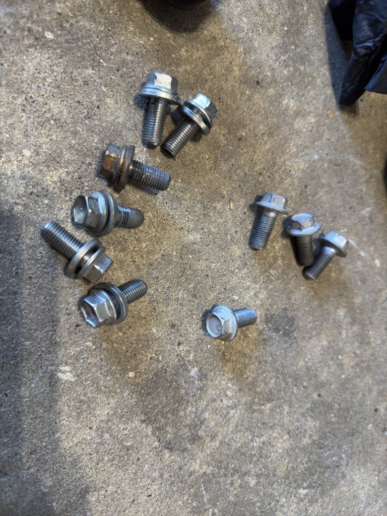

    All right - I’ve got 4 bolts unaccounted for. Maybe I figure out where they go as I continue, but I need to use 6 of these for the exhaust brackets and I’m not sure which 6. Then that will still leave me with 4 bolts I’m not sure what to do with. Any ideas?
    I had them all organized but I think they got kicked around. They don’t go on the transmission, so there should still be something on the truck missing these…
    on the exhaust brackets, I believe the 4 bolts holding the two brackets to the bellhousing have washers. Does anyone know of the one bolt per bracket holding the bracket to the cat has a washer or not? I think they do too but it’s hard to say.
    then once that’s sorted, next to figure out where the other 4 go lol. Transmission mount are accounted for, exhaust to catback are accounted for. Crossmember to frame are good. Shifter related stuff good. What else? I’ve gotta be not thinking about something.

    I think I was incorrect about having the transmission mount bolts accounted for. Seems I can no longer find them and the 4 that I do have, work. Must be them.
    Which would then mean the 6 washer bolts would all be for exhaust brackets.

    Heat shield for accumulator?

    Thought about that but nope, those have tiny bolts that I had.
    What ended up happening is I used the short transmission mount to crossmember bolts, on the transmission mount to transmission…I was pretty sure the mount to crossmember bolts were short (and they are), but I couldn’t find them. The longer 4 unexplained bolts are the ones for mount to transmission. So now I’m putting those in and now my short 4 are available for the mount to crossmember. Then the 6 are all exhaust. I’m good now.

    We can get you photos of ours if you need. Glad you’re on track. Nothing is more stressful than ending with extra parts.
