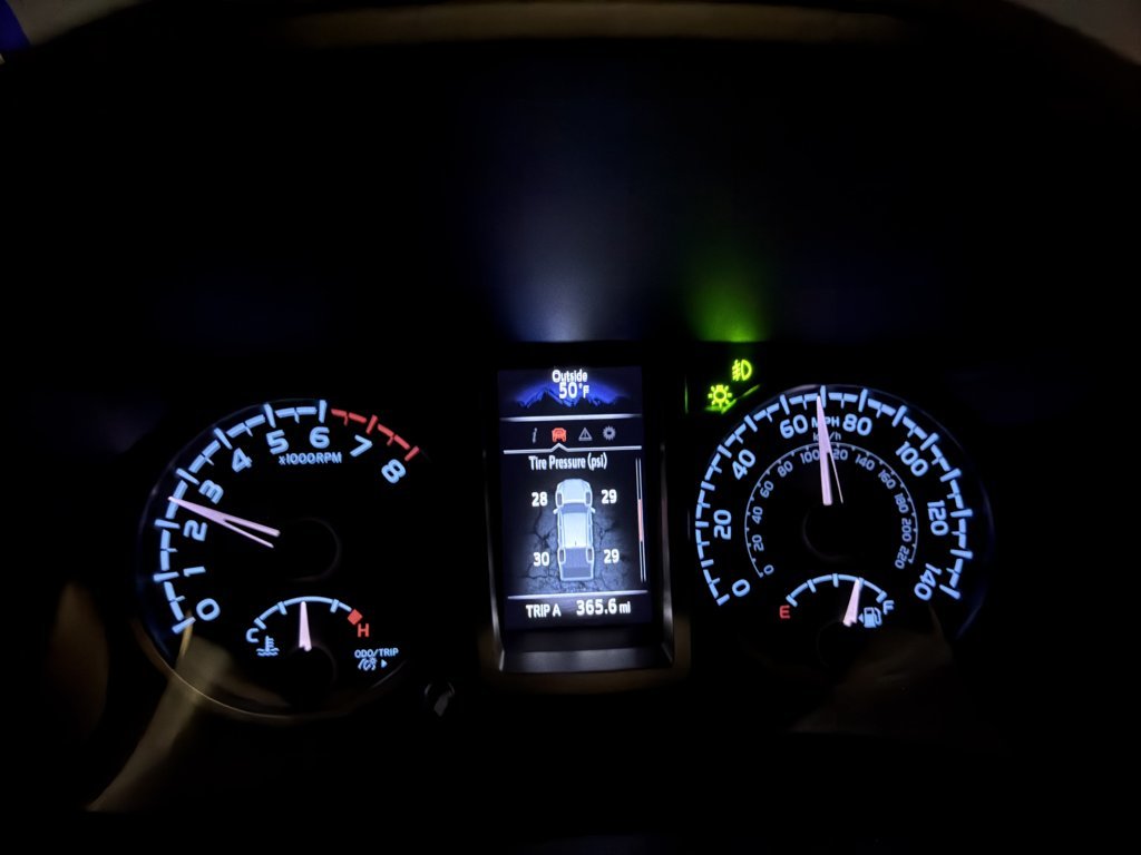

    Put probably 20 miles on it now. I really like this. 1st and 2nd I’m already used to on the street. They’re a bit short but I’m already used to that so this was just yet another adjustment. 3-6 feel really good. I thought I wasn’t going to like the taller 6th as I’ve gotten used to the torque of the stock 6th with the regear. I lost a bit of that pull, but it’s a lot quieter in 6th now and probably will get better mpg. I am cruising at 2600 at 70mph now instead of 2900.
    5th feels pretty close to the old 5th, so not much new there. It’s like 200 rpm difference (lower) at the same speed, so not huge.
    Overall, this is a great improvement. The low speed gears are fantastic. The top end gears are fine, not degraded compared to before. I have 0 regrets and I don’t think I need any more time to be sure.
    70ish:
