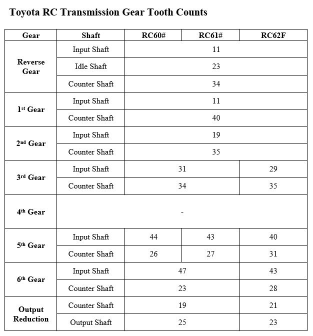

    The new gears are 4.784 and 2.423, vs stock 3.982 and 2.017. So they are further apart, but they actually proportionally identical. The actual gears making up R-1-2 in both transmissions are the exact same part number. The difference that makes the RC60F so deep in those gears is the tailset reduction (the fixed gears connecting counter shaft to output shaft). That one is 19T/25T vs stock is 21T/23T. So you now have a lower tailset gear ratio by about 21%, which is what makes those 3 gears exactly 21% lower.
    Which means for 5th and 6th to now be roughly 10% taller, they had to make the actual gears around 30% taller to make the net 10% taller since you factor in the lower tailset.
    This is a neat chart showing the different gear tooth counts in all the gears across the RC60, 61, and 62 transmissions. @Jeff Lange made it.
