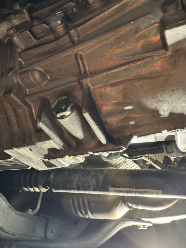

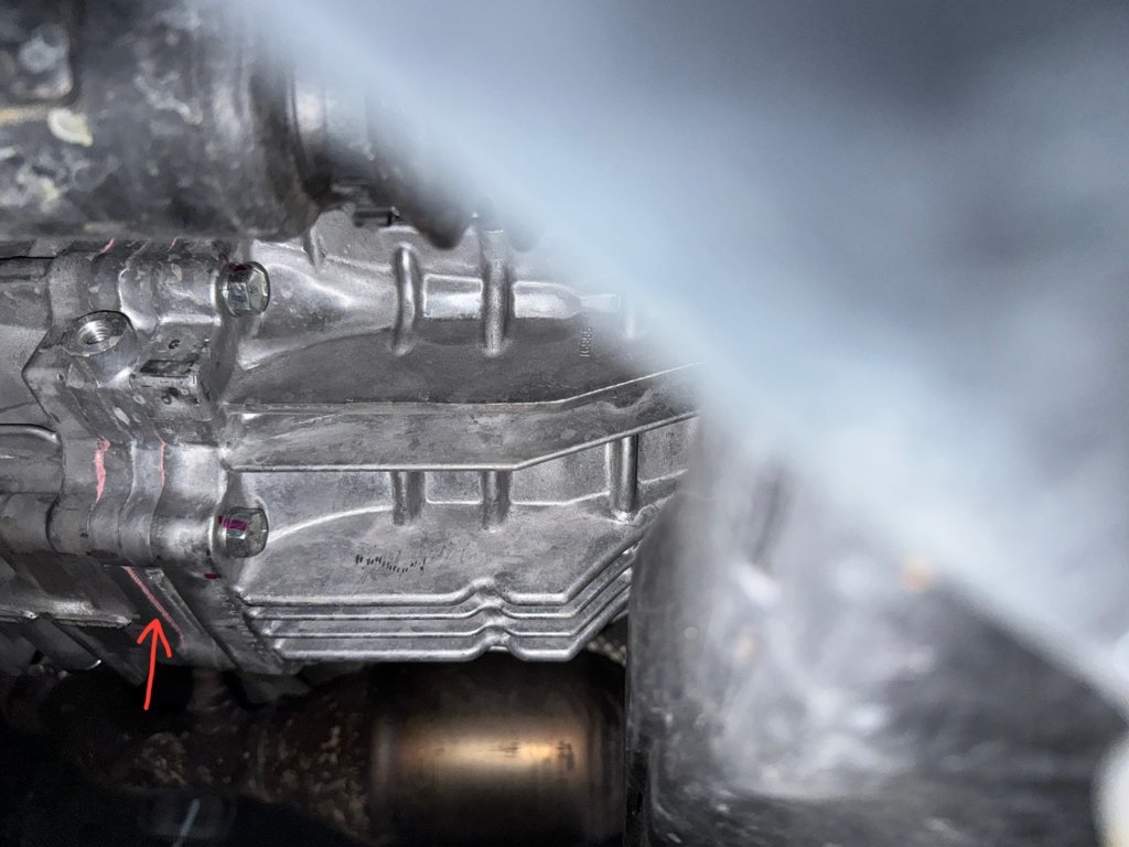

    After finding this leak, in addition to a variety of other things I don't like about this truck, I decided I'm going to upgrade to a 4th gen. It's not immediate, but it will happen eventually.
    In anticipation of that, I put out a WTT to trade my gears for some stock 4.30s (plus cash from them). I didn't want to put the transmission back to stock but keep the 5.29s, because that is just too low of gearing for what most people want (even if I liked it). So the first move was to get the gears changed back to stock to give me more flexibility. I found a guy on FB with a manual who wanted 5.29s, and we spent Sunday swapping. That was a bunch of work swapping diffs between two trucks.
    Because of this, I am now able to provide valuable insight as to driving this transmission with the stock gears, which is how I imagine most of you wanting to swap transmissions would do it. I am on stock size 265/70R16 Michelin Defenders.
    It's not as bad as I thought it would be. It's great compared to stock of course...the low gears are akin to regearing the truck to 5.29 axle ratios. The taller gears I am not a fan of, but it's not all bad. 6th gear is quite tall, just barely 2,000 rpm at 70. Very little torque to gain speed at that ratio. It seems like it may gain a bit of mpg, but I'm not using 6th much. We have too much speeding up and slowing down with traffic and if you get slowed down at all, it's just too much of a headache to have to downshift every time to regain a little bit of speed. I can see the value in this gear on a long roadtrip, but not really much other time. The good news, is that 5th is pretty much exactly where 6th was with the 5.29s, so it to me is a very good cruiser gear. Essentially, I am driving it like a 5 speed.
    I don't think this transmission is a bad swap at all for those with stock gears. Your usage of 6th may vary, it doesn't suit how I like to drive very much, so I won't use it much, but the rest of the gearbox is good. 3rd feels strong, and is a very good passing gear since it now tops out closer to 100 mph, good enough for most passing. 4th is not a strong passing gear but it would be good for towing, like stock. The low gears are no longer stupid low like they were with the 5.29s, which I didn't mind but it was over the top, especially 1st gear. That would have been good for crawling, which I don't do.
    For now I am monitoring the leak. Most likely, regardless of if the leak appears again or not, I am probably going to swap the transmissions back before trade in. I am tempted to disassemble the front case half and reseal it myself. I found the factory repair manual for the transmission and it's not that bad. Main things are getting the output shaft and counter shaft nuts off and back on. I won't be able to torque them but I would be able to get them off with an impact and probably on in a close enough spot with the impact as well. Then stake the nuts so they don't move. I don't think it will affect any internal preloads since the bearings are shimmed. In other words, I think fixing and selling this transmission is a real possibility.

    I forgot to respond to this, but I did check the case half fasteners, the ones towards the bottom that I could easily get to were all tight enough. I actually wanted to find loose bolts because then I'd maybe have a chance of fixing the leak.
    It must be a slow leak, because after wiping it, I have found no evidence of it coming back. I am just keeping an eye on it for now. I want to drive it for about a month and see if it comes back or not. That way I know if it's worth tearing down and resealing or not once I swap the transmissions back to sell the truck.

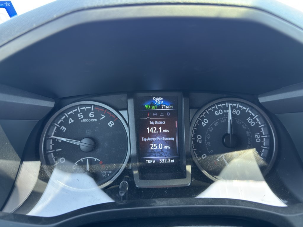

    Well. I guess this transmission has the ability to achieve good mpg in the right conditions.
    Went about 70 most of the way. Tank average was 21.6 because I got 19.6 on the way out. Not bad at all, this is my record for sure. I had 25.4 on the screen at one point but lost it.

    20+ mpg is awesome, i haven't driven a long trip but i can already tell my hwy mpg is a few better
