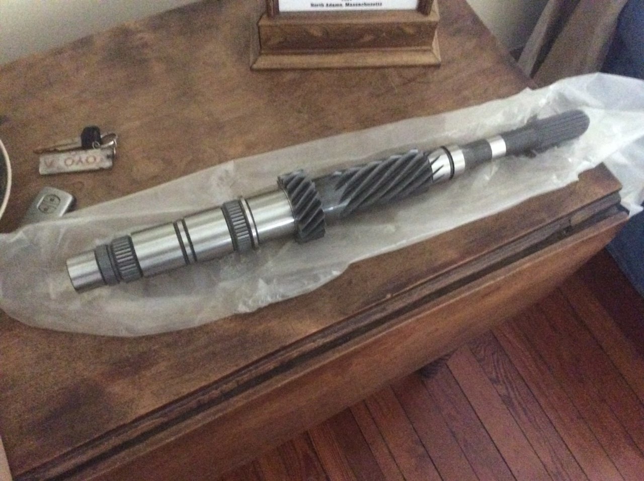

    The Hiace input shaft arrived today, length is correct.

    Having the shaft in hand, it's easy to spot an obvious improvement that was left on the table. I'll share that info as the build moves, more research needs to be done.

    The Hiace (shaft) and Hilux (transmission) are both of the RC60 variant, so ratios are the same.

    That was the whole reason he needed to get a different input shaft and not reuse the Tacoma's shaft. The Tacoma's RC62F has the wrong ratios to work with the RC60(F). This is an RC60 input shaft with the correct length for the 2GR engine and the correct ratios for the RC60F transmission.

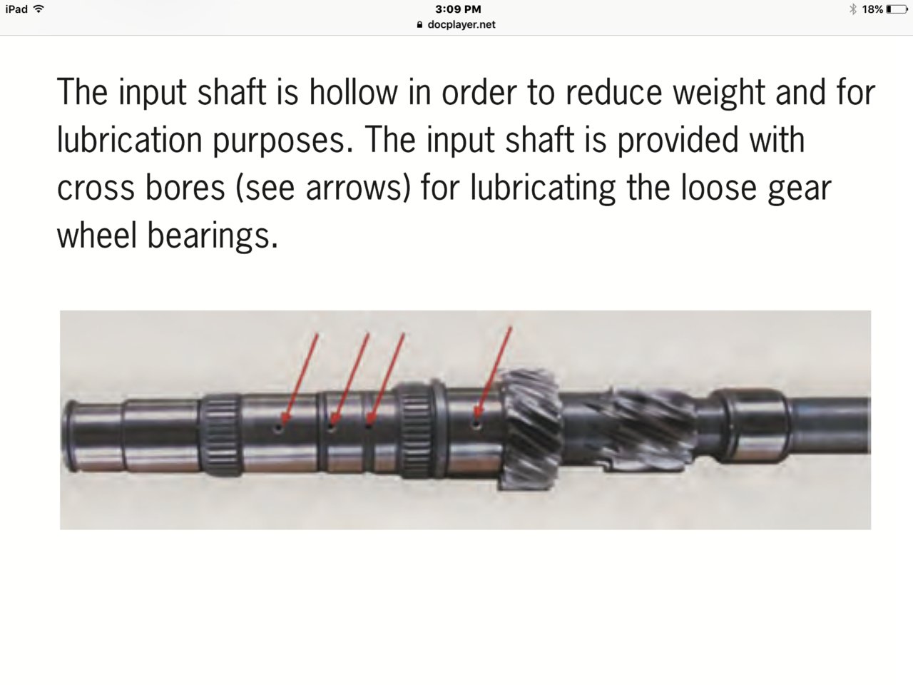

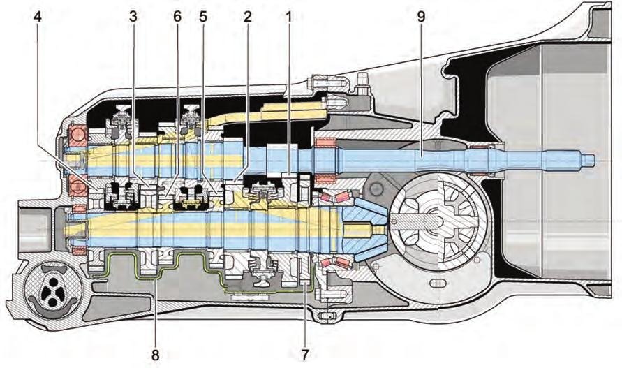

    Soooo I've been combing the web for anything related to the Toyota/Aisin RA/AY6 RC/AC6 transmissions that might help with building and improving. Long story short, I began looking at the Aisin SP6 Transmission that was built for the Porsche 997 Series cars. It has the same CD measurement, so that drew me in. Turns out, upon digging around, that it shares a bit of architecture with the RA and RC. It's simply built into a rear engine transaxle layout. There could (?) be some parts that will interchange, but they are probably limited to bearings, synchronizers, and other small parts. They are likely stupidly priced, too... so they would need to be vastly improved to be considered.
    Porsche input shaft.... look familiar?
    It's already crossed drilled for improved oiling and cooling.
    Complete unit, note that it retains the PILOT BEARING out at the tip of the input.
