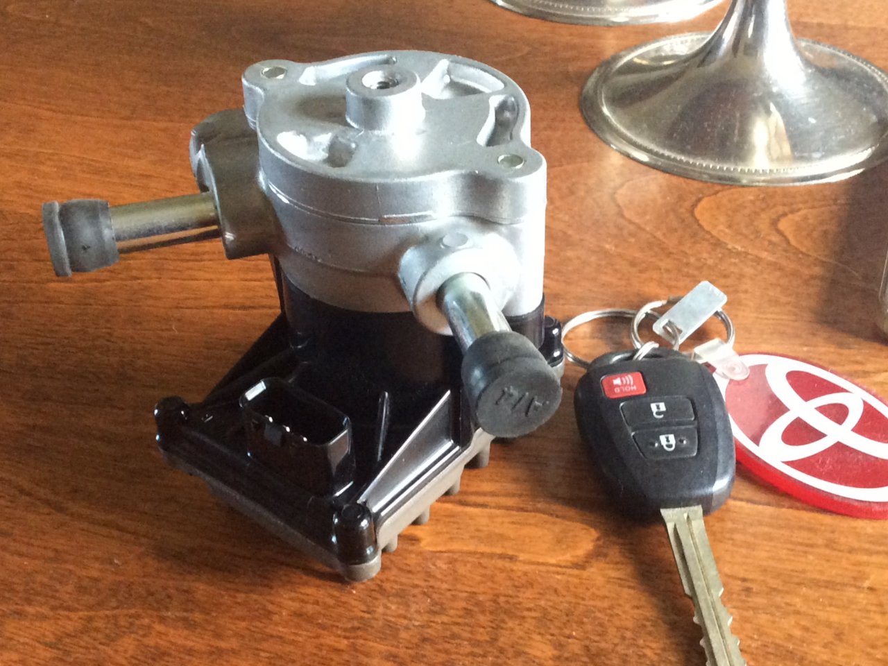

    Here is one of the pumps I'm looking into, it's a Toyota/Aisin unit from a hybrid SUV. I still need to research how the control board operates. The motor is a brushless 2.5 amp unit, so on the small side, but may prove more than adequate for what is required here.... that depends on what it thinks of pumping 75W90 vs Toyota CVT fluid, which is what it normally would be moving through the lube circuit/cooler.

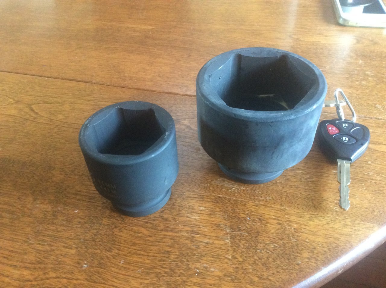

    Two large sockets that are required to disassemble the transmission.... A 60mm six point for removing the output shaft nut, and a smaller 41mm for the nut on the counter shaft. The counter shaft does not require disassembly for the main shaft swap, only for rebuilding or, in this case, access to cross drill the shaft for first and second gear bearings.
