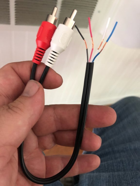

    Mr Marv sent me this left right rca connector that I need to wire to my speaker wire harness. I can not determine what the red, black, blue and white. Using my multimeter the pin and the barrel have continuity and that doesn’t make sense.
    Can someone tell me which is positive and which is negative for left and right?
    Red/black go to the red plug
    White/blue go to the white plug

    To have the speaker left right front and rear channels input into an amp from an adapter harness from the Tacoma OEM Head unit.
    Mr. Marv called me back and told me which is which
    Red is right positive
    Black is right negative
    White is left positive
    Blue is left negative
