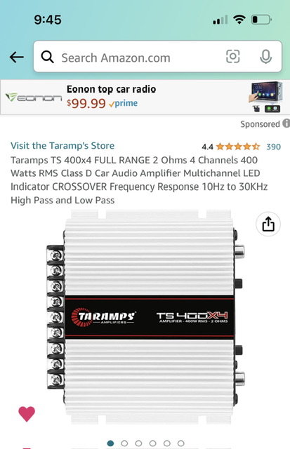

    Ok so I took on the project today and I replaced the dashboard tweeters with DS18 plug and play, did the front doors with DS18 4 ohm 6x9’s 500 watts max 250 rms both tweeters and 6x9’s a direct plug and play to the OEM head unit ! Now for the rear doors I used DS18 4 ohm 6.5’s 500 watts max 250 rms but I ran them to a Taramps TS 400x4 which bridged puts out 200 watts to each speaker . I also used a L O C which was plug and play for the OEM radio. What are your thoughts did I do everything right or should anything be done differently?
