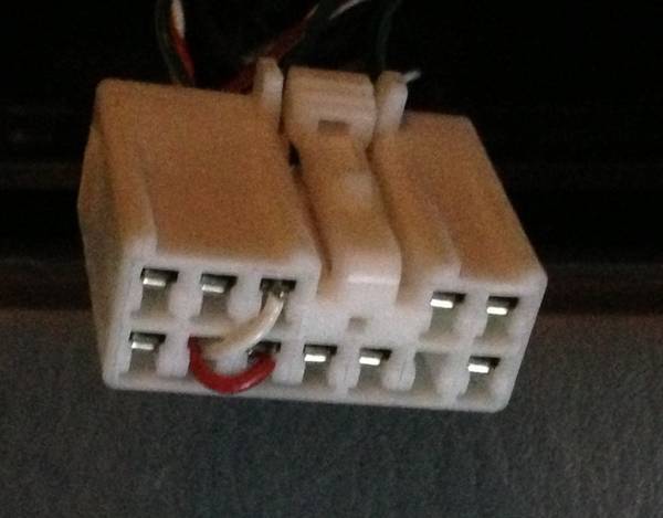

    What exactly is going on in your power splice ?

    OZ - not sure what you mean? What picture are you referring to?

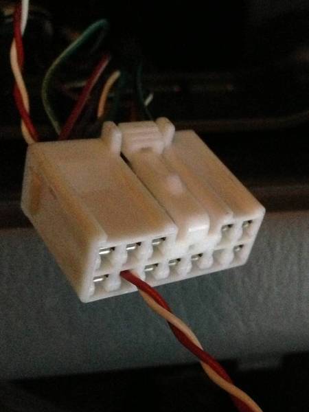

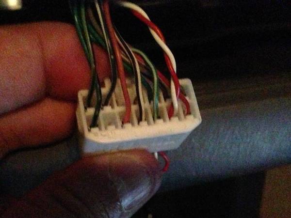

    Sorry , I should have been more clear . I went into your gallery and checked out your no solder power splice idea . I think I have it figured out though , you took the power wires through a blank in the plug and inserted them into the correct pins on the back side , correct ?
    Does the wire being in there cause any issue with re-seating the plug ?
  11. Sep 10, 2013 at 2:12 PM
    #2051
    satcom221
    satcom221 Well-Known Member
    Apr 22, 2010
    #35786
    141
    Rick
    Kingston, WA
    2023 Celestial Silver Double Cab SR5 4x4 SB
    VLEDS V tail conversion, gas cap holder
    Ok - yes that is correct, I used the empty slot closest to the required power pins. I stripped about 1/4" off the ends, inserting into the correct holes and made sure the insulating was just flush with the surface - pulling the slack back up through connector.
    Because the pins are actually 'blades', it provides a very snug fit. The wires will prevent the locking feature of plug, but trust me you will not need it. The first time I tested it I pushed it in hard and was a struggle to pull apart. No damage to the pins or wires and works excellent.
    Although I normally would solder my connections, this is a viable substitute. The entire install could theoretically be done with a good pocket knife or gerber tool.

    I was curious and looked at the connector behind the AC panel today and mine has a blade that goes through the spare you used as a chase , didn't seem like there would be enough room to fit the wires through there , does yours not have a blade that goes into that hole ?
  14. Sep 11, 2013 at 9:36 AM
    #2054
    satcom221
    Apr 22, 2010
    #35786
    141
    Rick
    Kingston, WA
    Oz, there is a blade, I checked several times to see if the wires were getting any damage. I tried to make sure that the wires were somewhat split so the blade goes between them. Seems to be fine, I can check in a few weeks to verify. But, I don't think there shouldn't be any issue if the wires are solid/snug with no movement then there won't be any chaffing.
