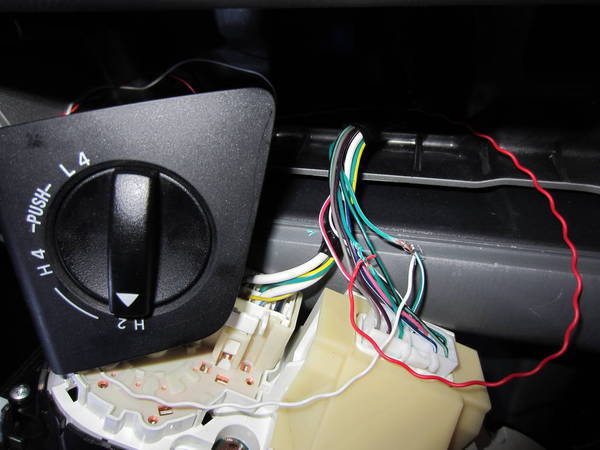

    Ok so apprently Im screwing up somewhere and this just isnt working for me. I followed the directions...i thought. But cant get it to light up in the truck. I installed the led back plate and reassembled the housing. Decided to just run the wiring to the A/C controls without soldering to the back since my soldering skills are subpar (i can do wire to wire but nothing else really). Here is where i run into problems. Because I skipped soldering to the back i hooked up the RED wire to the GREEN wire. The White wire went to the GREEN with WHITE stripe wire. (ignore the crappy wiring...itll get soldered and heatshrink tape once i know it works) Turned the truck on, lights on, everything and the unit would not light up. I also tried switching the wires just in case with no issue.

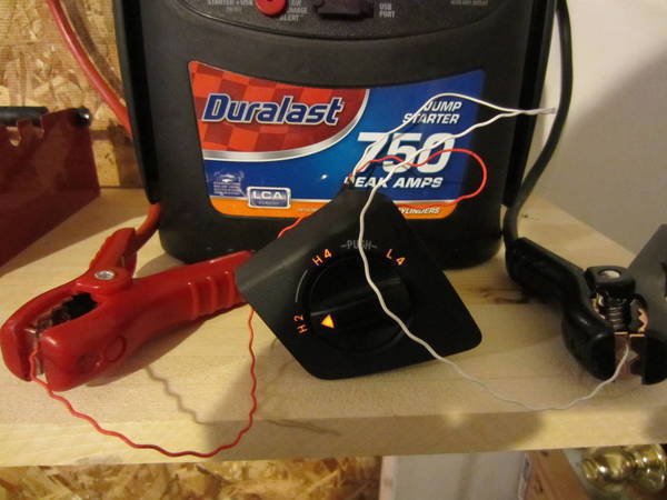

    Now to make sure i didnt screw up the unit somewhere i tested in on my battery jumper starter. It worked jut fine there. [​IMG]
