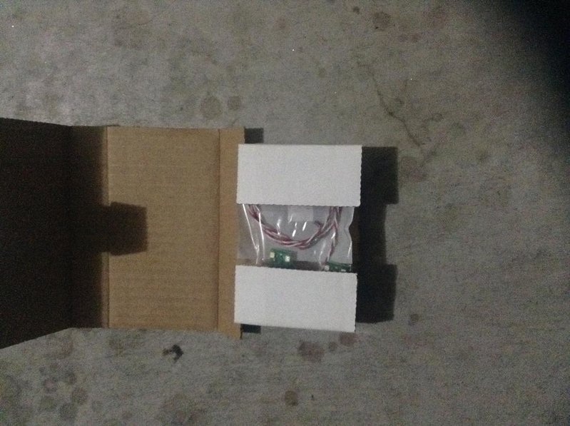

    RevoTaco,
    Got one! Never came out of the packaging.
