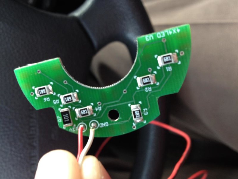

    Well that is no good, did you check for voltage at the PCB?
    Do you know what revision of PCB you own? I had a few that one of the resistors would fail. If you take a picture of the back of the board, the side with the resistors on it, I will be able to diagnose for you.

    Here is those photos please advise, I miss my lighted 4x4 switch

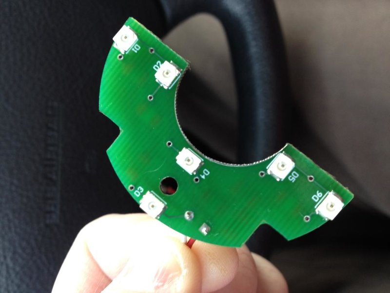

    And the other side

    R7 Is the usual place for a cold solder joint. Are you handy with a soldering iron? If so, touch up the two ends of that resistor. If you still cannot get it working, let me know. If you are willing to pay shipping both ways, I will fix it for free for you.

    I sent you a pm for your address, I am terrible with a soldering iron.
