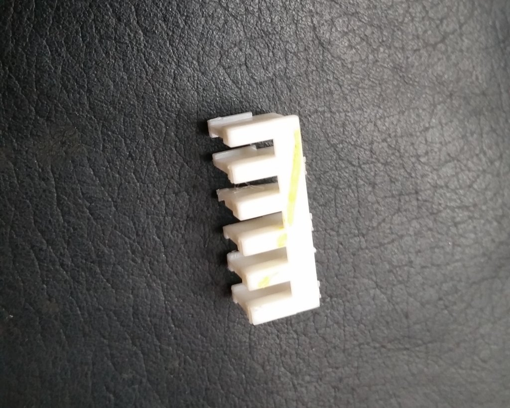

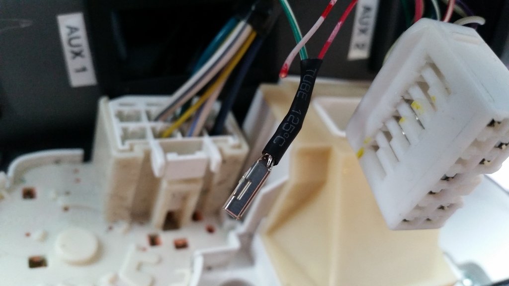

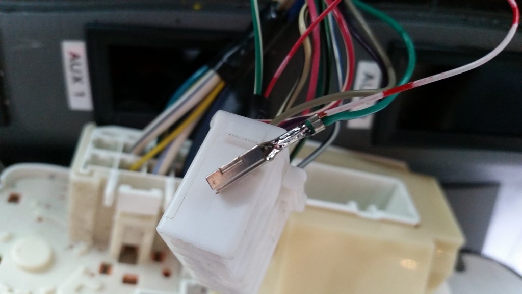

    I had a little bit of time today so I got this installed. I don't really like to strip wires if I don't have to so I pulled the plug pins out, threaded the wires into the pin and soldered it in place:
    You have to remove this clip first:

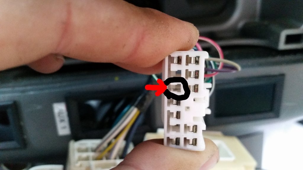

    Then use a pick to hold the internal clip up:

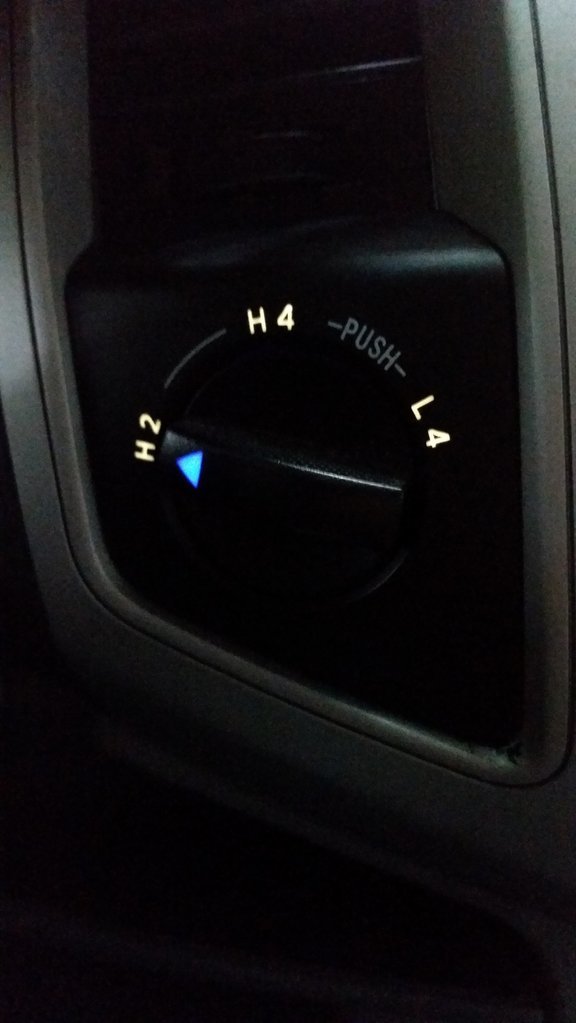

    Everything worked great!

    That's pro, looks nice!
