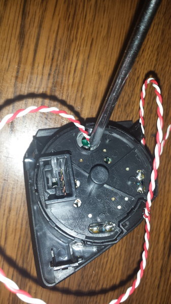

    Installed and working great. I thought I was done after soldering to the switch, so don't forget the power part! I burned the insulation off of the ac green and white/green wires with the soldering iron. The hardest part for me was positioning those little wires to solder to the switch. They kept wanting to shift. Fun project!

    Installing this circuit board in switch housing could Not have been easyier.
    What a great product.
    Directions are really good. But i got confused around...pg.9
    soldering the red and white wires coming out of switch? Then continue to ac area?

    Correct. You need to hookup the red & white wires to a positive and ground wire that powers when the dashlights are on. The easiest and closest place to do this is using the wires that power the A/C switch backlights.

    I guess what's got me confused is..
    Once I shut the 4x4 switch back up..
    Red&white wires coming out do I cut and solder to switch as pictured..Or do I run to ac area for power.?
    Or both..lol

    Technically you could do either....but it would be best to (and the instructions tell you to do the following):
    1. Cut and solder the to the switch
    2. Solder the now loose ends of the wires to the AC area for power
    3. Add the molex pins on your newly soldered wires into the 4x4 connector.
    Doing this will allow you to plug in & unplug the switch if needed.

    Ok i got it now. I was over thinking it lol..
