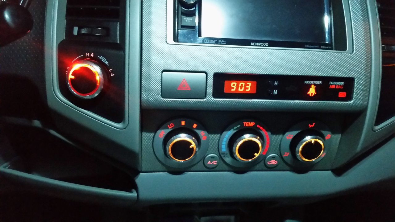

    Which ones do you have left? I bought the stock amber and after installing, it doesn't match. For whatever reason, even though the lettering on my hvac controls is amber, the lighting for the knobs is white. Looks like Im going to need to order the stock amber with white arrow for it to match. 20180116_210134.jpg btw...Great product! Ive come across some Tacoma guys wanting this light mod.

    Yeah. A cool little feature. Saw them on a forum somewhere. Might have been here. Anyways.. You can get them in black or silver. Amazon search for "Tacoma hvac knobs" will find them. I pulled one off to check after I did the install last night and it is white that lights up the ring. I'm going to have to order the stock amber with white arrow to get the same look.

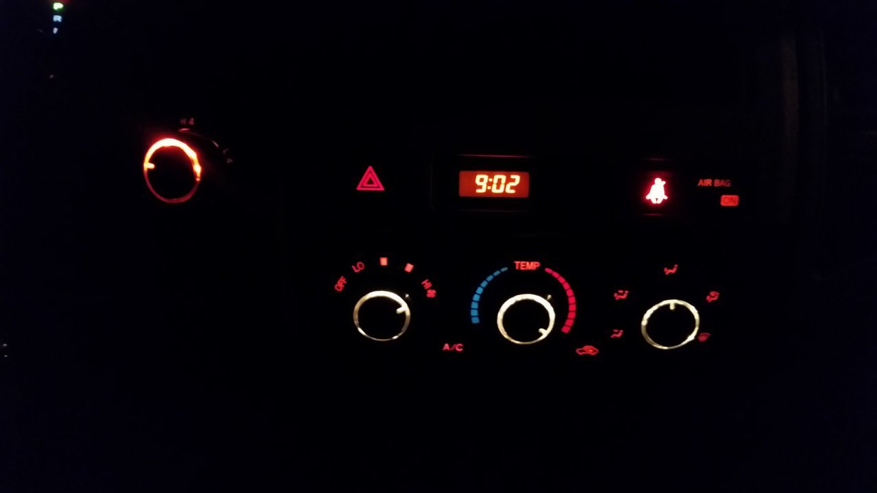

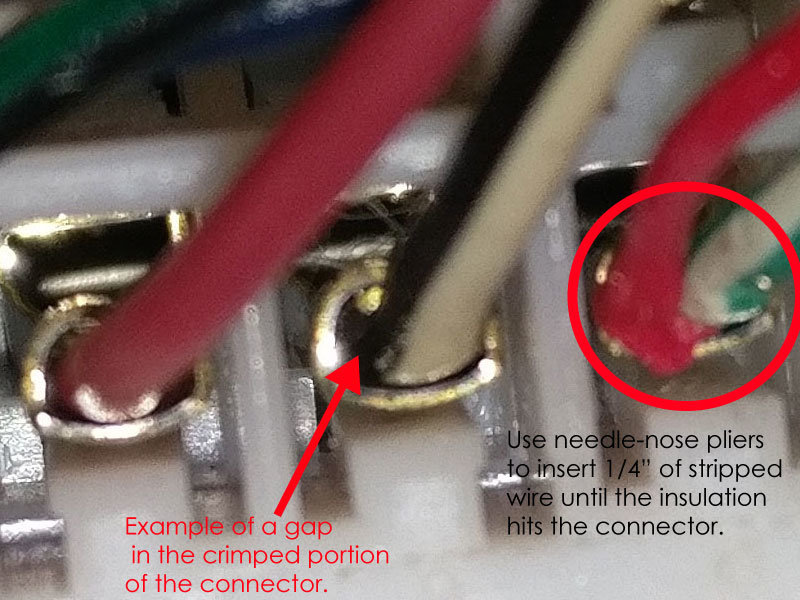

    Very nice kit...it came well packaged and was really easy to install. That said, I'll make it even easier.
    There is no need to make a splice for powering the module. As the attached picture below shows, I just shoved the wire (something that can be done because it is a stiff solid conductor wire) into the back of the appropriate connector. It's tight, but that's what makes this work so well.
    To prevent it from being pulled out the next time you remove the AC control panel, wrap the two wires around the AC control panel harness a few times and tape over the wrapped section before you insert the wires as shown. I personally never use electric tape because I hate dealing with the sticky residue later, so I used self fusing silicon tape.
    Hope this helps someone.
