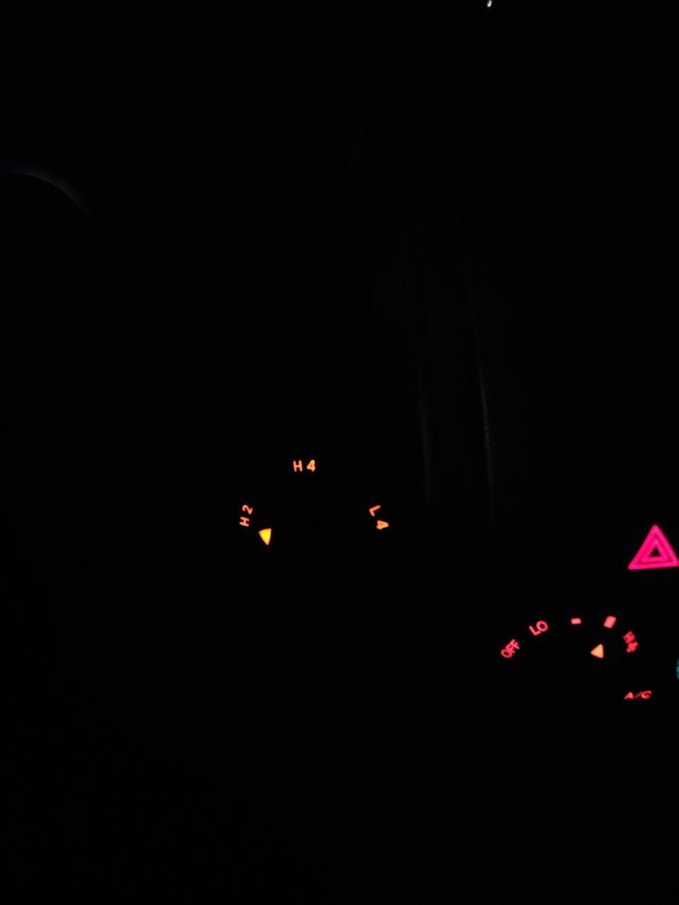

    '08 DCSB TRD RT
    Little bit of this and that
    Mine arrived today and the install went flawless. Thanks again for building these!

    im a little confused on the instructions. is the only connection to the switch harness via the molex pins, or do i also have to tap into the A/C harness?
    rcbs204[OP] likes this.
  18. Jul 21, 2020 at 8:37 AM
    #3238
    Rezkid
    Rezkid Not a Well Known Member
    Sep 16, 2019
    #305481
    1,018
    TJ
    WTX
    '08 DCSB TRD RT
    You will need to tap into the ac harness. The molex pins allow the board to connect to the factory connector but you will still need to connect those wires to a dimmable power source. I followed the directions that the OP posted in Post #1 and had no issues.

    thank you sir. so i just splice off the wires with the molex connectors, and plug that in to the ac harness?
  20. Jul 21, 2020 at 3:03 PM
    #3240
    Rezkid
    Sep 16, 2019
    #305481
    1,018
    TJ
    WTX
    '08 DCSB TRD RT
    Negative. Molex ends go into the truck side of the plug harness the other ends get spliced into the ac harness.
    "Step 4: Cut and solder the red and white wiresto the back of the switch.
    Step 5: Using the excess wire that was cut off, connect one end into the connector that plugs into the switch.
    Step 6: Solder the other end of the excess wire into the green and green/white wires in the A/C harness."
