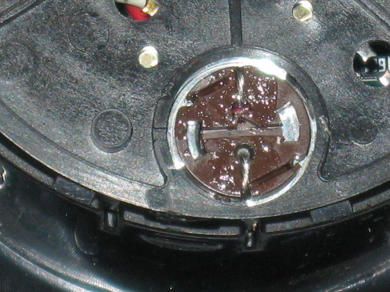

    The attached pic shows how I used the factory power clip to wire in the LED board. Takes a bit more time and is just another way to accomplish the same thing.
    The two small holes in the center of the clip, for the wires, need to be reamed to about 1/2 mm or so. the wires are locked into place by a bit of CA glue on the top (outside) of the factory clip and along the top slot that the twisted strands are pushed into.
    The wire continues in the slot down the side and along the bottom where it makes a connection on the metal spring, that you would have soldered to, when the clip is inserted and locked by a CW twist of 90 degrees.
    The important thing here is that you need to look at how the clip is locked into place so that the red wire ends up on the top and the white on the bottom ( as in the picture) in order to match the instructions.
    At this point you just carry on to the A/C panel to finish up.
