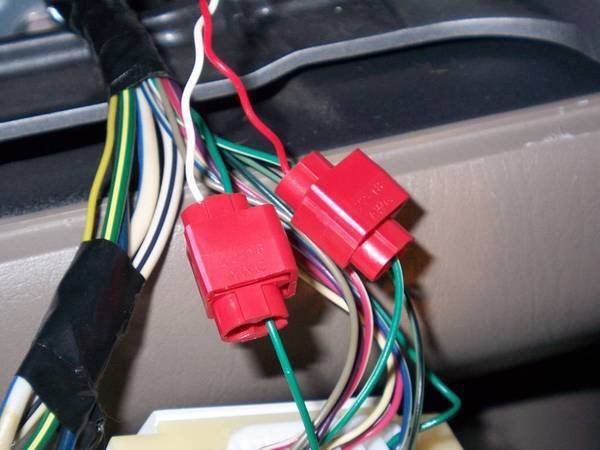

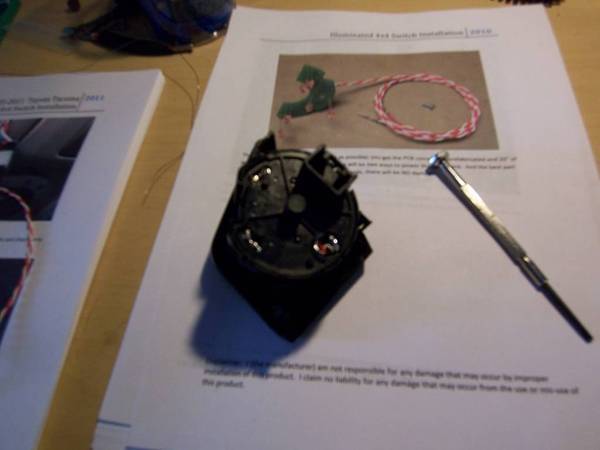

    Finally got it installed today...awesome! Thanks, you did a great job on the PCB...nice little commercial product. I chose to use splices as I personally don't like to cut the factory wiring. Here's some pics of some specific steps I took.
    I did the solder method as described in the procedure:
    I was expecting the pins to snap into the connector, so I wasted some time messing with it. However, the provided female pins connected with the male pins just fine...so I connected the socket, made sure it was snug and zip tied all the wires together for strain relief. The pic also shows where I ran the wires to the AC panel, there wasn't an easy way to run it with the factory harness bundle:
    As previously mentioned, I chose splices since I don't like to cut into the factory wires:
    I like to secure splices. I also zip tied the wires for strain relief:
