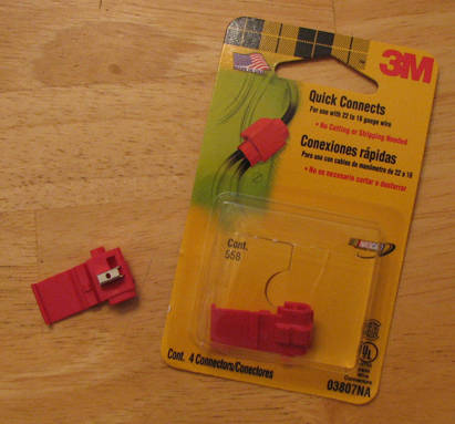

    Got mine last week! Now I know why the SST's don't fly any longer 'cause you use 'em to deliver these boards! Thanks a bunch!
    So I did it a bit differently in that I soldered the wires to the inside of the switch - that way I could leave that tab that needed to be removed on the switch housing intact (no wires or solder show on the outside of the switch) and if the switch ever needs to be removed there are no wires showing whatsoever. The soldering was easy and the wires are on there solidly. I also ran the wires inside of the cable hosing as far as I could after connecting the Molex pins to the connector.
    In connecting up to the AC harness, I found that these 3M quick connects worked like a charm. I got them at Wal-Mart for $1.38
    The hardest part of this for me was getting past the intimidation of tinkering with the electrical wires on my new Taco. Glad I did it - can't thank you enough for the fantastic mod and the great delivery service!

    And, as I said in my post, the 3M quick connects just did the trick very easily on the power supply end of the wiring. What I did there, just to be certain the wiring up to that point was good, was to strip about 1/4 inch of insulation from the end of the two wires and then shove them into the A/C cable bundle (the white to the green and the red to the green/white) just by sliding them alongside the corresponding power wires so that I'd be certain I had everything right before clamping down on the quick connects.
    The entire process was actually very easy and fairly quick, I just tend to get (unnecessarily) intimidated by mods like this one - but the end result was just great!
