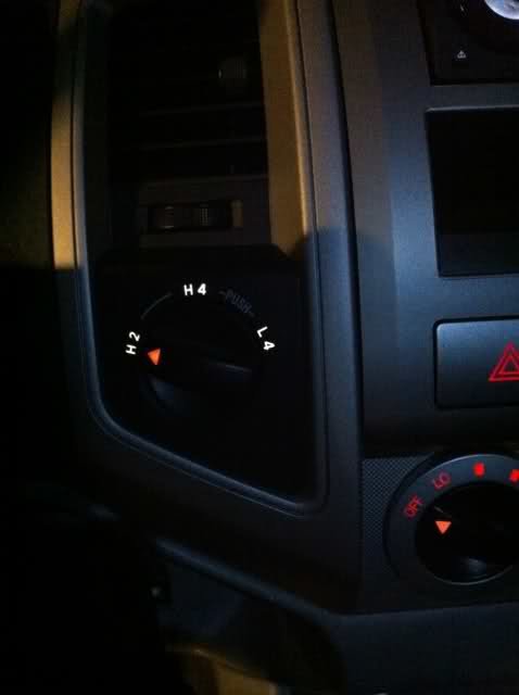

    Got mine installed today. Looks great! Just like the factory SHOULD HAVE DONE!

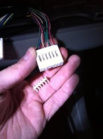

    BTW, I found a better way to solder on the power wires. If you popped this guy out you can then pull the pins of the OE connector out and solder to the base of it, then snap the pins back in. No shrink tube, no stripping wires!:

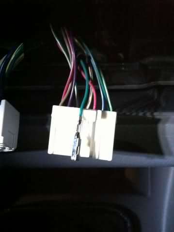

    Got everything all hooked up and working then went to put every thing back together and broke one of the pin connectors in the AC plug.
    Does anyone know if Radio Shack sells these pin connectors?

    egads! radioshack does not carry them. you have to go to the dealer.
