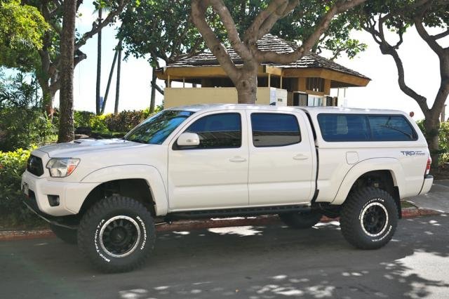

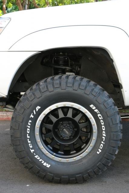

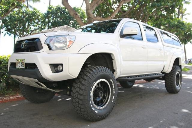

    I've been through pretty much the most popular suspension options from spacer lifts (Daystar and Revtek), coilovers kits (OME, Icon, Toytec) to a 6" Fabtech Dirtlogic kit.
    I have to say, hands down, the 4.5" RCD kit is the best in terms of ride quality, performance, engineering, looks, stance, etc...
    We just did the the full RCD installation video yesterday on our main production truck. Here are a couple before and after shots.
    Before: 2.5" ProComp suspension (not leveling kit) and 265/70R17 Nitto Trail Grapplers on ProComp Extreme Alloys
    After: 4.5" RCD suspension with 1/2" Toytec top plate spacer and Toytec 1.5" rear AAL, 305/75R17 (33.9"x12.2") BFG KM2 on 17x8.5 Method Double Standard Wheels

    were you able to achieve "green" alignment specs to pass recon ?

    Thanks guys. No recon yet... I may need some flares depending on who does the inspection but the alignment will be to factory specs as my UCA's and CV's are close to the stock position. Also, I have no vibrations with this kit, only from the KM2's:D

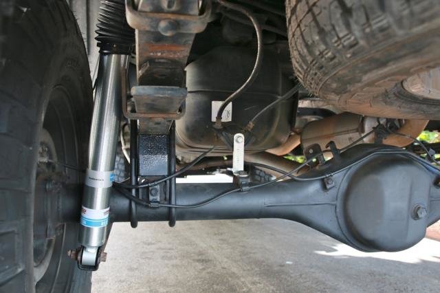

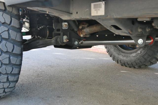

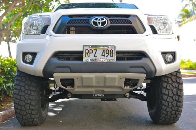

    A few more pics showing the CV axle angles, TRD skid mounted and Toytec u-bolt flip kit:

    How is the turn radius on this kit? Heard the fabtech is horrible and was wondering how it was with the different spindles provided?

    I imagine the same, the steering stop doesn't change from the looks of the pics unless the RCD kit comes with new spindles.
