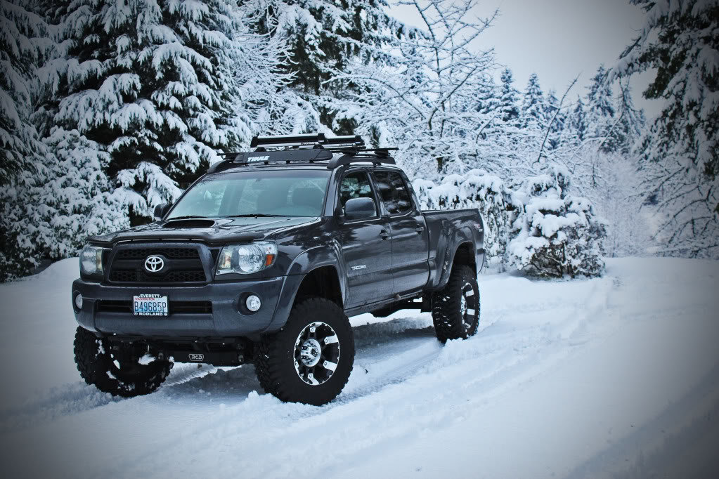

    2011 Tacoma TRD SPort
    RCD 4.5 inch lift kit
    snowed here today and loved driving it in the snow!
  2. Jan 15, 2012 at 7:57 PM
    #342
    sandjunkie
    sandjunkie Well-Known Member
    Aug 22, 2010
    #42055
    1,871
    Aaron
    OC
    NICE!!!!
