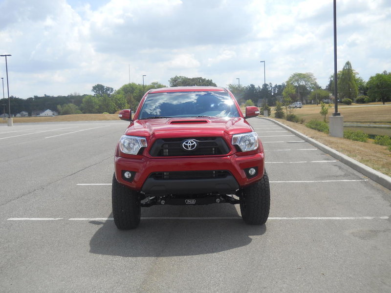

    i'm in the same boat. my RCD kit came missing one of the centering washers on the front bracing... i'm having difficulty getting RCD to call me back. I went through Wheelers Off Road and they've been great and have been trying with RCD as well. Looks good though. Once I get it, I can align it and take it home!!! Here's the current shot...

    well got some good news, found a washer and now its home and it looks sweet. definatley wish i would have done this in the first place but live and learn so i cant complain. truck looks good apples

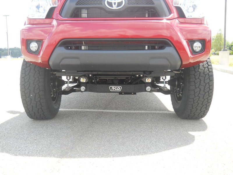

    thanks man! mine finally got to go home... has some clunks and creaks... is that normal???:confused:

    Mine does not do either of those, it's a very quiet ride. I love the quality of this lift.

    Not Normal.:eek: I would check things out. Mine has never made a sound, even offroad.

    Crap. Mine rides well. I don't really know what to compare it to because I've never lifted. Definitely not a factory ride and it does make a creak/clunk noise as it went over a speedbump. Now I'm starting to get ill. :mad:

    Issued diagnosed and corrected! Like PaganTacoma, my sway bar was touching the factory skid plate braces. We put a sturdy piece of rubber between those metal pieces but it was still so tight it severed the rubber in two after 24 hours. Since I'm not using that factory plate and they are thin metal, I assume they really don't have much use, so I just removed them. Good as gold baby.

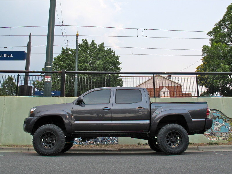

    Here she sits...

    Beautiful. You running the blocks in the rear?

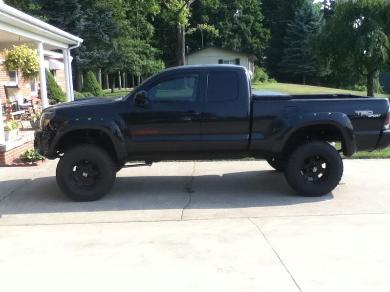

    before and after
