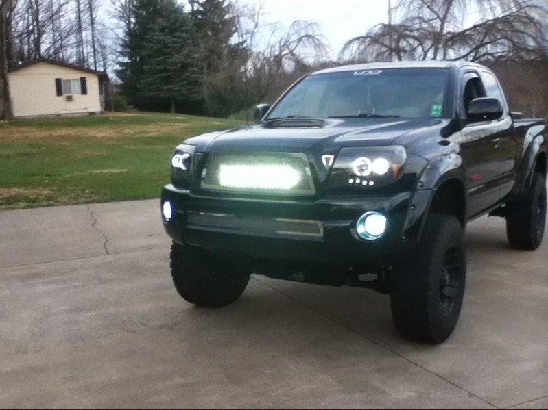

    dont know if i posted this but here is a pic of mine
