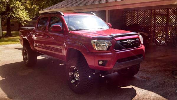

    Only pic I have so far. Crappy quality cell phone picture. Better ones to follow this weekend.

    Looks good! I like the look of the 12.50 width.

    Most pics I see of others seem to be pretty straight CV angle or just slightly down pointing. Take a front on shot when you get a chance so I can see what yours look like.
    Truck looks bad ass of course :)

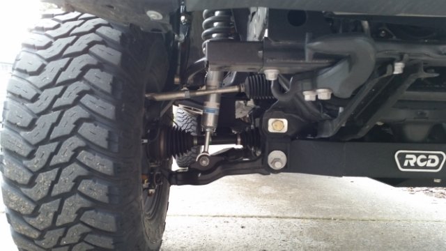

    I just took a pic of the cv angle. This look like yours?

    Mine look like that exactly.

    Mine are def more angled down. I know part of it is do to some positive camber currently(getting that fixed this weekend.) I'm measuring 26 7/8" from center of hub to wheel flare. Man it's bugging the shit out of me lol.
