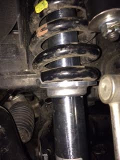

    Hey NoRemorse did you ever figure out the issue with your CV angles and extra hight?
    Could you take a picture and post of your front shocks were the bottom of the spring rides on the shock.

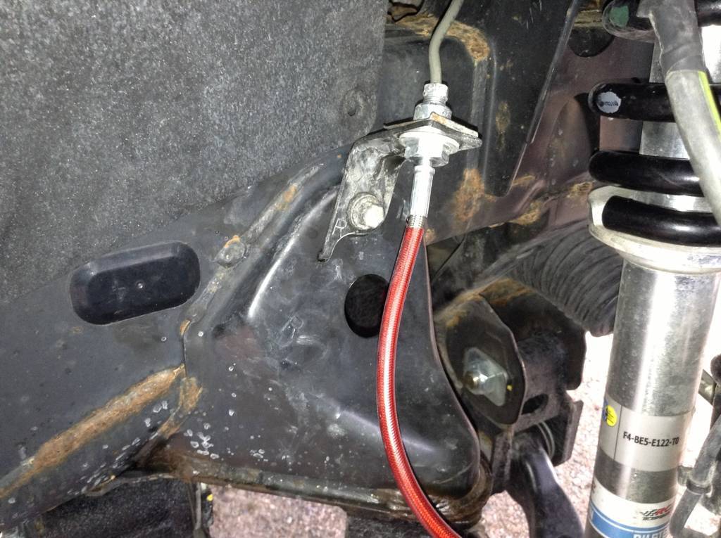

    I never got response yet from the salesman at the dealership re: the prior owner and if he changed the coil spring. Both my coils are seated perfectly on the alum coil seats. Here is a pic I took this weekend after installing my new extended stainless brake lines. You can see the coil seated in there too.

    its hard to tell by that angle but I had mine put together at a shop with a spring compressor I believe they installed mine upside down so going to verify today. heres what mine look

    Def upside down

    Holy shit mine are too, guess we know where the extra height is coming from now.

    Ya I know and the funny thing is last night as I was walking out to my car to go home after everything was complete except getting the rims in it poped into my head out of no where so I went back looked said damn it and took the picture because I thought of NoRemorse

    God bless ya lol, it's been driving me insane lol.

    I take that as yours are on correct and that's not your issue.

    Mine are def upsides on too

    U mean upside down?

    Yes upside down, stupid iPod lol

    Well there u go glad I could help.
    I have no idea why that popped into my head last night especially when everything was done and ready to go but I'm happy it did now and not later. I had been thinking of your issue during install to c what would cause your issue and that's probay why.
    Now they come back off flipped and hopefully my rims will be here today so I can drive onto the next Mod.

    That's why I love this forum. Kinda a little ticked though. Last guy I took to I specified please confirm the strut was assembled correctly. In his defense and mine there is a notch in both sides, so I could see how it could happen. Can't wait to get this fixed so I can order my custom Alcans for the rear lol.
    Thanks again, that was a big help.
