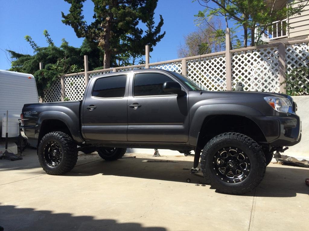

    Yay count me in to the straight axle club, lol. Dropped her off at the shop this morning and got the spring seats flipped, fresh tire balance and alignment. Part of me is happy all is correct now and part of me misses the extra inch lol. Those 295's are def tight in there now. Not rubbing but dam close at full lock.

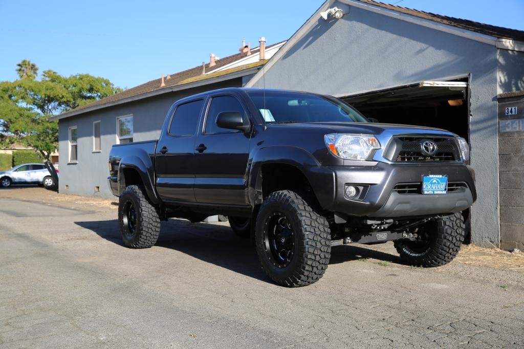

    RND2 Well-Known Member
    Apr 20, 2014
    #128082
    276
    In my head swimming around
    12 DCSB
    RCD 4"
    looking sweet NoRemorse.
    Just drove mine home been sitting on jack stands since saturday waiting for the wheels to show up.
    The ride is better than expected and everything in the kit is all you need to complete the job.

  8. May 13, 2014 at 7:36 PM

    We hit the same issue with no 12mm allen head on hand You can use a torx bit as well in a pinch. I don't recall the size but it worked flawless.
    Truck looks awesome man. And of course the color is the best Tacoma color ever lol.
