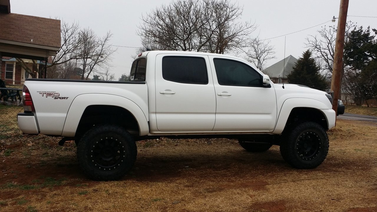

    k thanks I just don't want the lowrider look front higher than the back

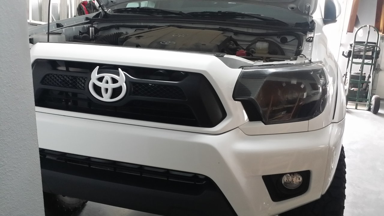

    Haven't had the rcd lift long enough to discover any issues but it's a very solid built lift that should give years of performance free problems.
    My FJ had Allpro UCA's with Icons before switching to a TC long travel with King shocks and both sets of UCA's squeaked if they weren't lubed regularly.

    Truck looks great! As for squeaking, it might be your sway bar rubbing on the front brace. I and others had to throw a few washer in between the brace to stop the sway bar on the drivers side from hitting. Mine made like a rub sound when you hit bumps. Just a thought.

    Good point my sway bar had about a 1/16 gap and I knew it would start hitting when the truck was in motion so a few washers were added to give more room. Im going to machine a couple new blocks next week or machine off a little bit depending which way it needs to go

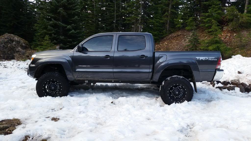

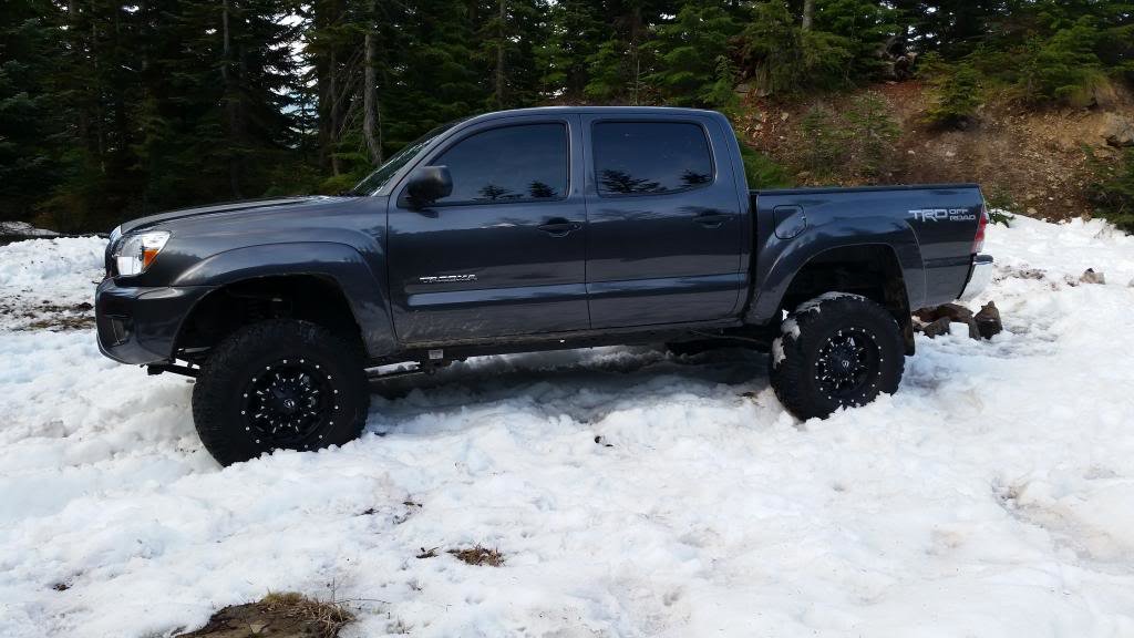

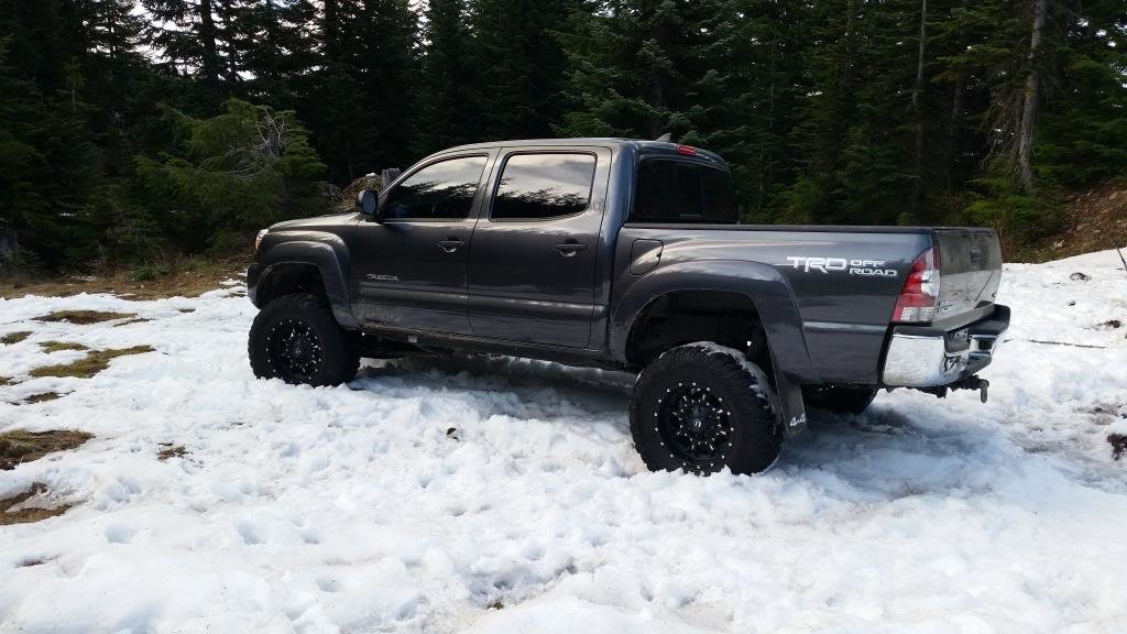

    Had some fun in the hills yesterday.

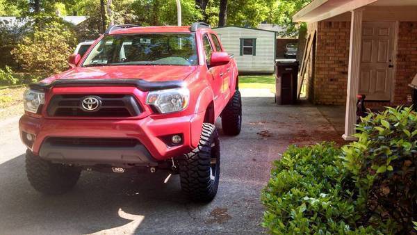

    Can someone running 33x12.50R17 on 17x9 wheels with 4.5 BS please post a pic of the front and/or back so I can see how much further they stick out than my 285/70s do?

    That's what I'm running. This is only pic I have at the moment.
