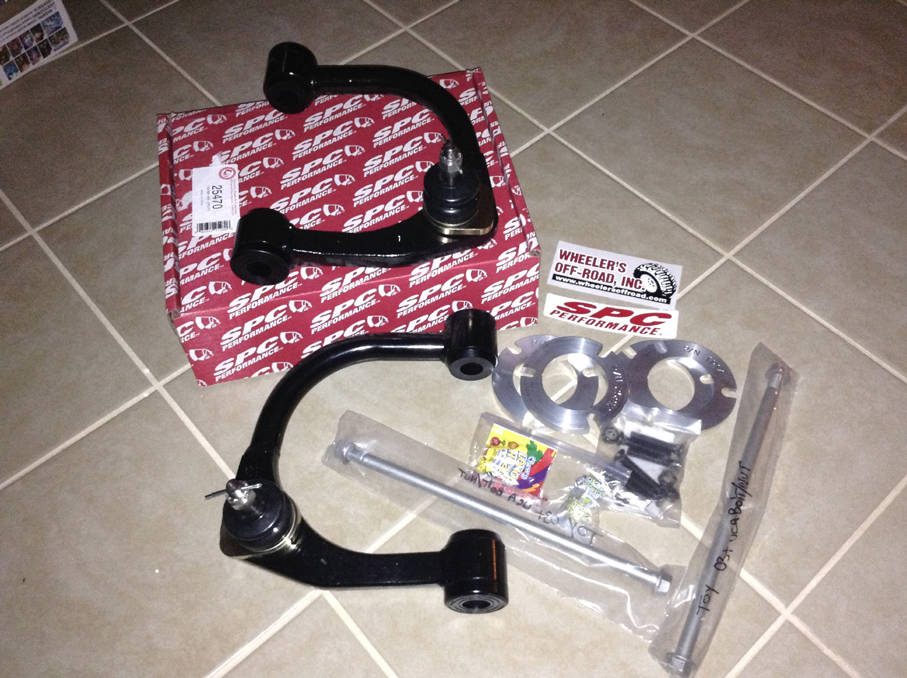

    Mine don't rub under most normal driving cases, Just once in a while when turning hard. Even when they don't rub they are very tight at full lock. I knew going in that a 295/70/17 or at least the trail grapplers were a hair over 33" and I might have some issues. I just got my LR UCA's in today and the paper in the box states you can gain more clearance at the rear of the tire with these UCA's. with caster set to max. I'm pretty sure the combo of the slightly over 33" tire and my springs being a little saggy in the front is my problem. It prob didn't help them driving them around for 3 weeks with the coil seat flipped and preloading the coil. With everything installed correct I get about 25.5"-25.75" from center of hub to the wheel well. I think wobble gets 26"
    Edit:
    Box of goodness came in lol. even got stickers and candy, lol. I got the spacers from ToyTec because wheelers was out of them.
    WTF ToyTec, I didn't get any stickers or candy from you guys lol.

    Nice. You already installed these RIGHT!

    My truck only had 500 miles on it when I measured 26", so it may sag a touch over time. I'm curious where you will be after the spacers.
    You're going to LOVE how the truck rides with those UCAs! I put mine on +2 degrees (which is 0 on the chart) and was able to get 3.95 degrees positive caster with the factory adjustments maxed out (for max tire clearance). My girlfriends truck (same lift) was only able to get 3.6 degrees caster with the UCAs set at +2 degrees, so we moved it to +3 degrees on the UCAs in order to achieve an end result 4.2 degrees caster. I adjusted the UCAs for max positive camber on both trucks and the camber dialed right in. This also gives most clearance between the ball joint and the coils spring.
