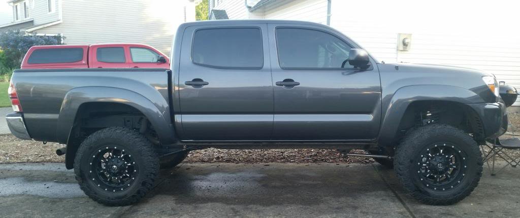

  7. Jun 3, 2014 at 8:04 PM
    #1147
    wobble
    wobble Well-Known Member
    Mar 20, 2013
    #100151
    490
    Ridgefield, WA
    2014 TRD OR
    Modified RCD Lift, 315/70R17 STT Pros
    Here is a pic with Dakars and 1.5" blocks. Also debadged it today.
    20140603_195745_zpsjzoogpl_edit_14018507_1ded99b808cd4657cc0b2622b3eab1f467b6d5b1.jpg

    I have significantly more driveline shutter with the Dakars and 1.5" blocks (not tapered) than with the 4" blocks. I'm going to try that carrier drop bracket.
    Since you want 5" rear lift, you may want this drop bracket instead:
    http://stores.streetacos.com/carrier-bearing-bracket-2-1-4-2005-2014-tacoma-5-higher-rear-lift/

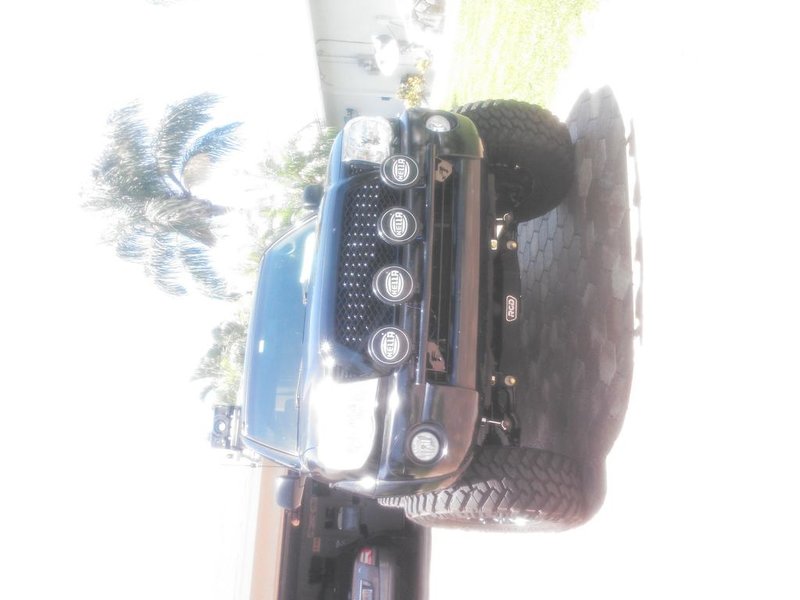

  17. Jun 9, 2014 at 7:39 AM
    #1157
    wobble
    Mar 20, 2013
    #100151
    490
    Ridgefield, WA
    2014 TRD OR
    Nice! Those 315s are really stuffed in there. Any rubbing issues?

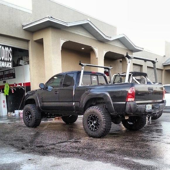

  18. Jun 9, 2014 at 8:51 AM
    #1158
    rtgreene10
    rtgreene10 Well-Known Member
    Mar 8, 2014
    #124854
    437
    Fl cracker
    4x4 turd
    Yeah had to cut the fenders and most of the plastics in the wheel well as well as the cab mount. We had to run my 1.25 spacers to clear the knuckle.
    Haven't flexed it out much so we will see how that goes.

  20. Jun 9, 2014 at 9:21 AM
    #1160
    wobble
    Mar 20, 2013
    #100151
    490
    Ridgefield, WA
    2014 TRD OR
    Those do stick out a bit. Looks good!
