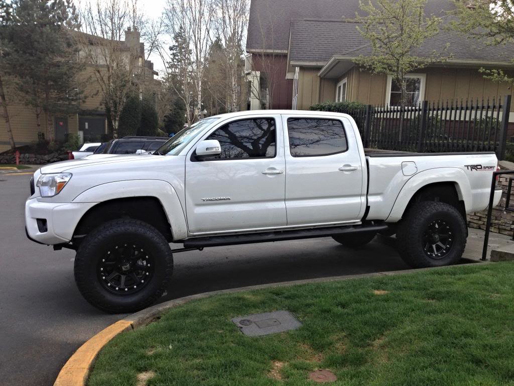

    Looks solid. Love the MTZ's. Great all around tire

    Looks mean! I just bought the exact same truck. Only difference is I put a Snugtop camper shell on it. I'm looking forward to putting the RCD on

    DCLB look way better lifted than stock. Nice Tacos guys
