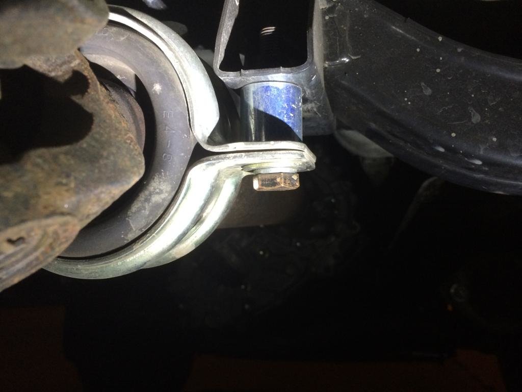

    It comes with spacers that lower the bearing.

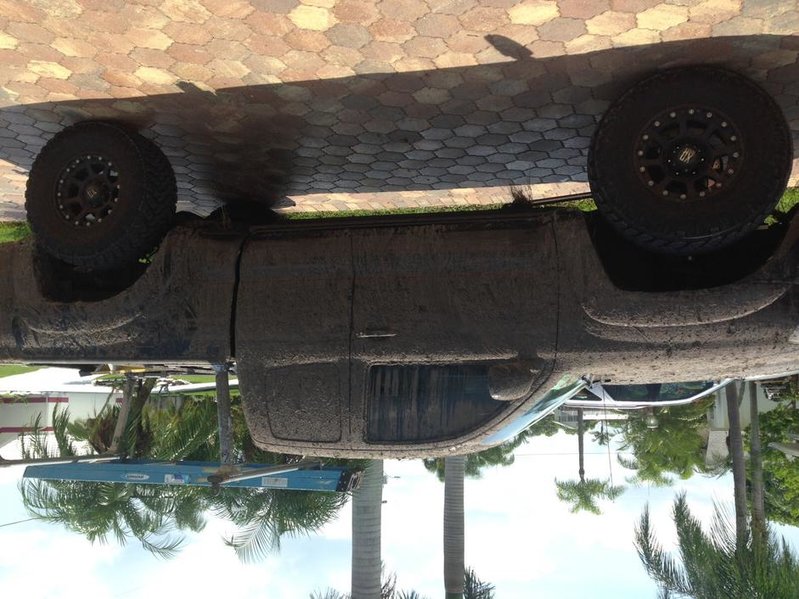

    RCD was put to work this weekend and did great!
    Edit. Stupid phone makes the picture upside down

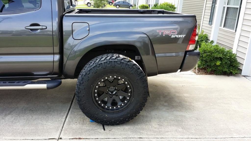

    Here is my question that has me stumped. My setup is starting to rub more and more. I have the RCD kit obviously, with Total Chaos UCA's and 33-12.5-17 tires on a 17x9 wheel with 4.5"BS. The first few months had no trouble. Now it is starting to rub on the frame on the back fender well. I talked to Wheelers, they said the TC UCA's tend to sit the wheel farther back in the fender well and the factory springs are probably settling. They suggested to increase the caster on the lower control arm and maybe get OME 883 coils. Not sure I agree with adjusting the LCA's as my alignment is within factory spec. Is anybody else having this problem or using different coils? My 09 had no issues at all.

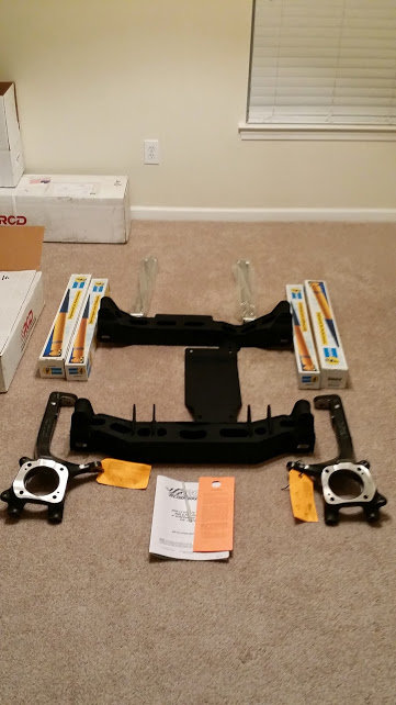

    Finally got everything in! Now to wait for next weekend to have the time to put it all on!

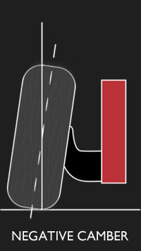

    If you had the Lr uca's you could adjust your camber to avoid the rubbing. Not sure I agree with adjusting your lca's either and if you add 883's it would put you nose high. You could always add a 1/2" top plate spacer which whould yield you atleast 3/4 lift but you would need to change your bolts to longer ones on your top hats.

    Camber's not going to effect your rub. The aftermarket UCA's that TC, Icon and AllPro
    make adjust the caster rearward for lifted trucks to help get your caster back in alignment
    With the RCD DB design your not effected like people who install and crank up there coil overs for height.

    What's your caster at? With larger, heavier tires, factory spec for caster results in twitchy steering. Getting your caster at or above 3 will both move your tires away from your fender and improve the handling of the truck.
    My truck has the caster set at 4 and has plenty of clearance between the tire and fender.

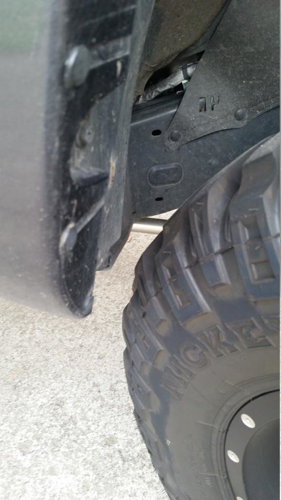

    Hi guys not trying to thread jack but after my lift billys at 1.75 I'm having passenger spring rub on my uca the truck came out looking huge for only being set at 1.75 I originally wanted to stack a 3/8ths toytech spacer plate on both sides to gain lift with out maxing the 5100s out at 2.5 and having travel issues I don't have the alignment numbers but they just barley got it into specs does this sound strange to any one else. Trucks an 07 sr5 stuck 32s under her look like toys feel like I could be clearing 35s any recommendations on what ucas I should look into thanks guys
